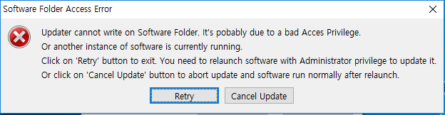

I have a error message when i open the cube mx
khyun.8
​whenever i open cube mx, this error message make me be nervous

Have you installed it with Admin rights ?
Have you been following the hints given in the message window ?

Hi @khyun.8​
It seems that you have not access to the updater folder due to access rights
As workaround
  • Try to change the updater folder to a placement you have access On
  • Be sure you installed CubeMX with admin rights
  • try to run CubeMX with admin rights
Perhaps also report make/version of anti-virus software running, and version of Windows and Java. ​
