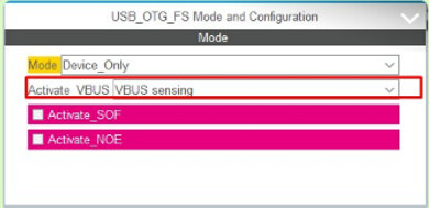

good afternoon, can you tell me, I have a board with two usb (micro and mini) through the mini connector I program, and through the micro I want to send data. I fiddled with the USB Vurtual COM port implementation, tried to send string data, but the data in the COM port was not displayed. Then I started looking for the problem.
As a result, I found that there are 2 bottlenecks:
  1. It's not clear if VBUS Sensing needs to be turned on. I tried both with and without it, all the same, the data is not transmitted. But judging by the description, you need to turn off VBUS.

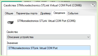

2.
The virtual port in the device manager is displayed as STLink Virtual COM port. And here in the information the name will not coincide with what I asked in CubeMX. Those. only the virtual COM port for STLink is visible, and this is the mini usb input, and the micro usb is not displayed. have you encountered this?

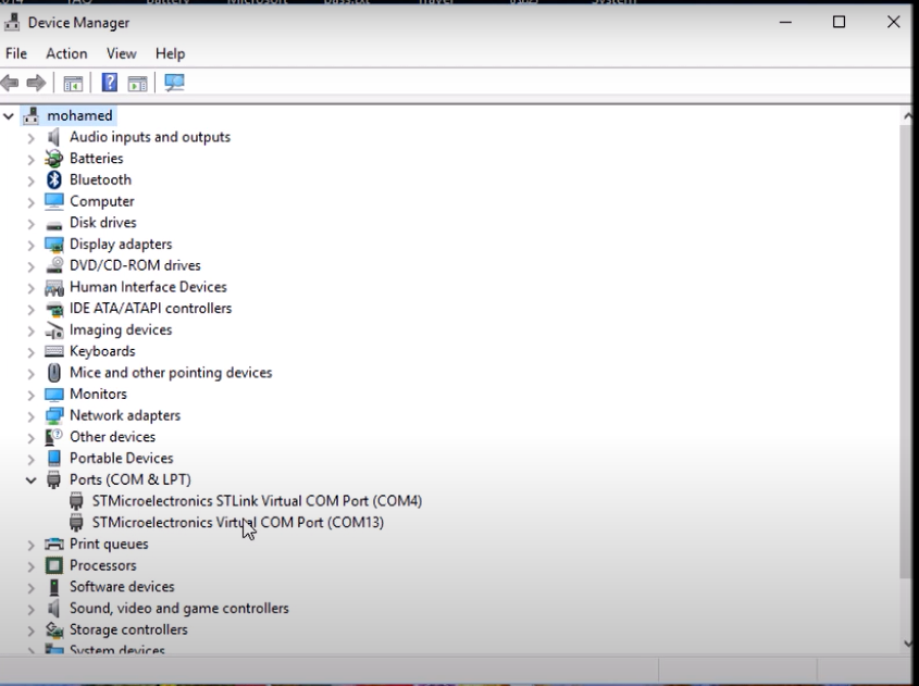

I have an STLink Vurtual COM port displayed, that is, a virtual COM port from the USB MINI side.
the question is: I understand correctly that the same Vurtual COM port should be displayed on the USB micro side and then there should be 2 virtual ports? but my second one is not displayed.
I am enclosing an example.
I found a video that displayed 2 virtual ports, but 2 are not displayed for me.
https://www.youtube.com/watch?v=7oED-m34EKk
0693W00000AMZNJQA5.png/Dmitriy
Peter BENSCH
No, the virtual COM port is currently only routed via the debugger USB port, i.e. the one with Mini USB connector. In fact it is one of the physical UARTs of the STM32L476 connected to the STM32 acting as debugger.
You will need to insert a USB CDC to emulate a VCP directly from the target (STM32L476) if you need a 2nd virtual COM port via its USB port. This is what the guy in the video did.
