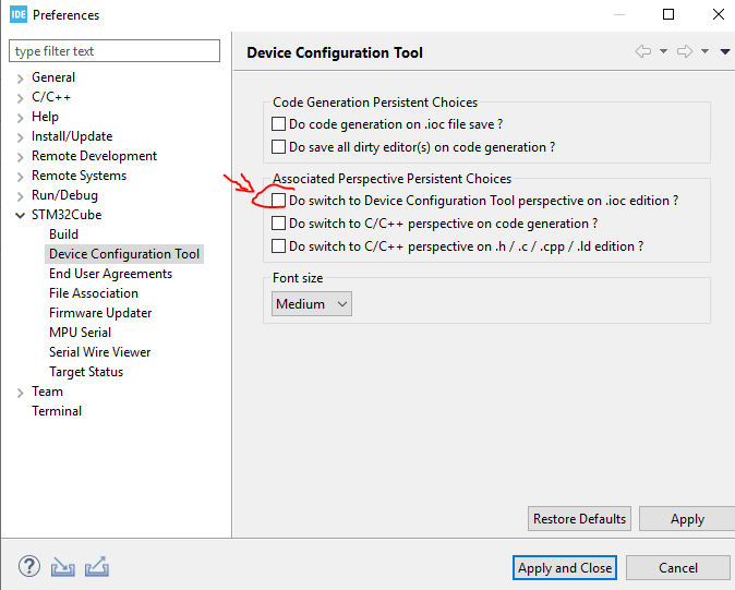

Went to that site in preferences. Restore Defaults, apply and try again. No success. The STM32CubeMX is still launching automatically and I don't get a pop up window to choose if I want to launch it or not.
Uncheck all. Dont forget to apply.​
Here is snapshot where to act:
