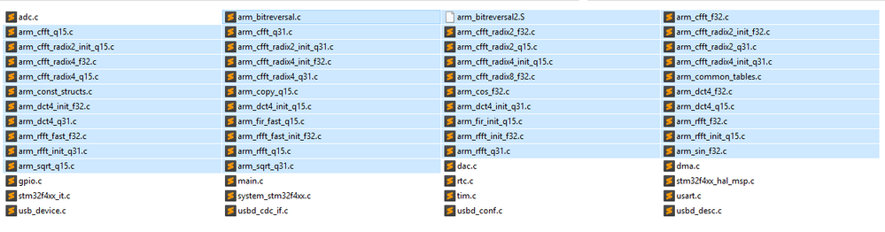

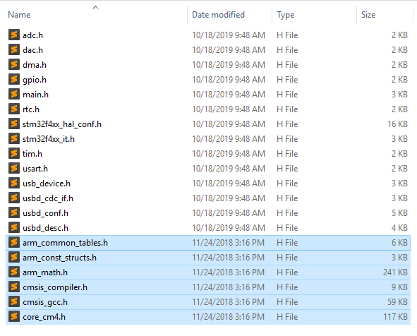

I thought might help someone with the same issue in the future. I managed to compile the project by adding the fallowing CMSIS libraries,
In the \Src and \Inc directory, I add the fallowing,
