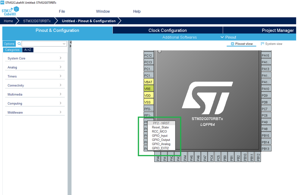

Hi. I want to configure pin 12 on STM32G070RxT. On DataSheet from ST it is called "NRST", but in STM32CubeMX, this pin is called "PF2". Where information is right?

‎2019-03-25 12:49 AM
Pin 12 on CubeMX :

And what information is right? Bug in CubeMX or in datasheet of STM32G0x0?
‎2019-03-25 8:39 AM
​@Community member​
This is a CubeMX issue and it will be fixed in next release.
