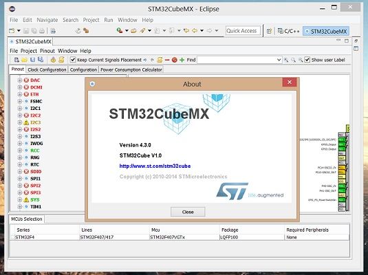

From the above image it can be noticed that the STM32cume MX version 4.3.0 has been added to the Eclipse.
I'm not able to generate the C code for the eclipse platform.
How do i generate the C-Code for the Eclipse platform.

STM32CubeMX does not support the Eclipse toolchain. STM32CubeMX generates C initialization code that you can import in your Eclipse project. STM32CubeMX supports project generation for a set of predefined toolchains (EWARM, MDK-ARM, TrueStudio): specify the IDE under the menu Project > Settings.
