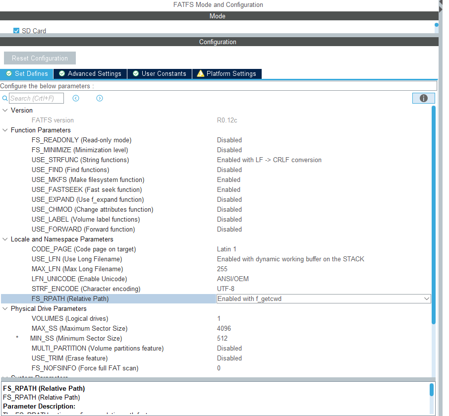

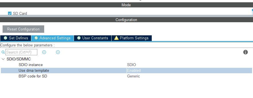

hello, ı want to communicate sccard via sdio with fatfs . in while loop and before while my code is working. but my code is not working timer callback and gpio external callback. this error is fr_disk_error or fr_no_filesystem. ı searched everything but happened.
cube Version: 1.5.1
may you help me pleas. how to solve this error (return = fr_no_filesystem)
thank you advance
Hi dear Ayuks,
Actually Timer's callback is not a good place for doing something like that. You can set a Flag as well and use it in main loop. I think you're doing great.
About why did you get those Error I have no idea. If it's important to you, you can easily debug that with your own and see what's going on there.
In addition, when you get those Error you can re-initial the fatfs and make it to work. You can try re-initial for tens of times to get FR_OK.
Ayuks.1
which flag is set? may you help me . why not happened exti callback?
You have to consider a flag (everything that you want) for this purpose and set it in the callback. And you have to check it in your main loop. Anytime that flag changed to set you can do everything that you want in main loop (for example reading from SD-Card).
You can't do large calculation or heavy communication in callbacks. Assume, if you be in a callback and have a new data you may lose the new data. So you are forbidden doing something like that in the callback.
But in your case, maybe you haven't configured well your NVIC Priority. Maybe you set Priority of Timer or EXTI higher or equal with SDIO DMA.
Ayuks.1
thank you brother ı changed nvic priority well work.
