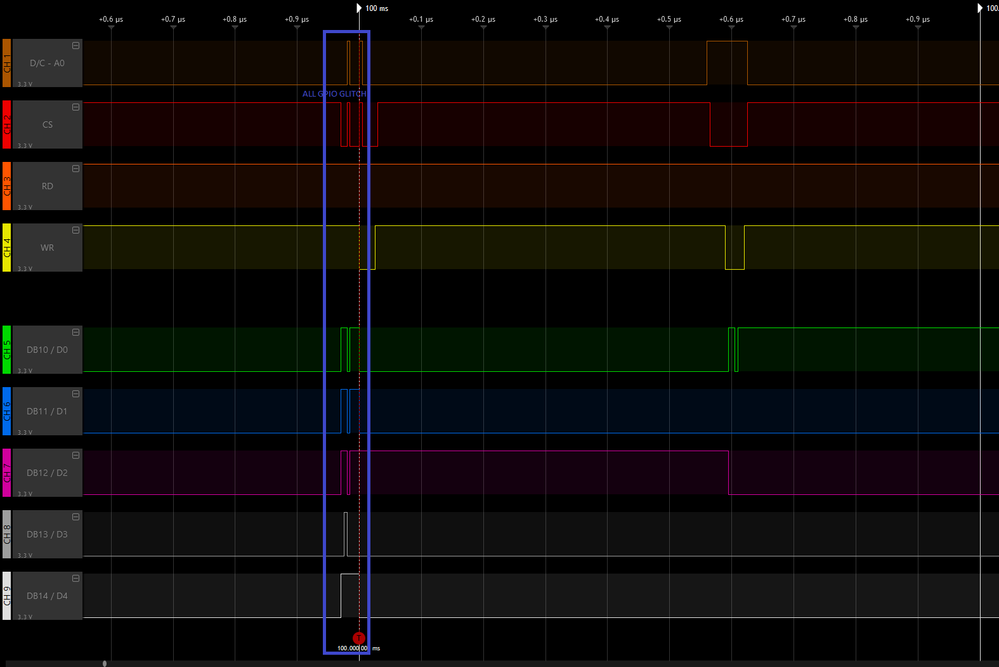

I am working on STM32F746ZG and I am trying to interfacing a display using FMC peripheral.
But actually I can't get it work... My display seems to receive some commands but I can't successfully send color.

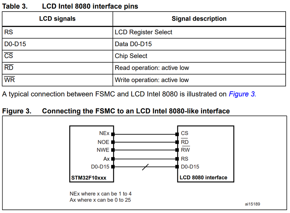

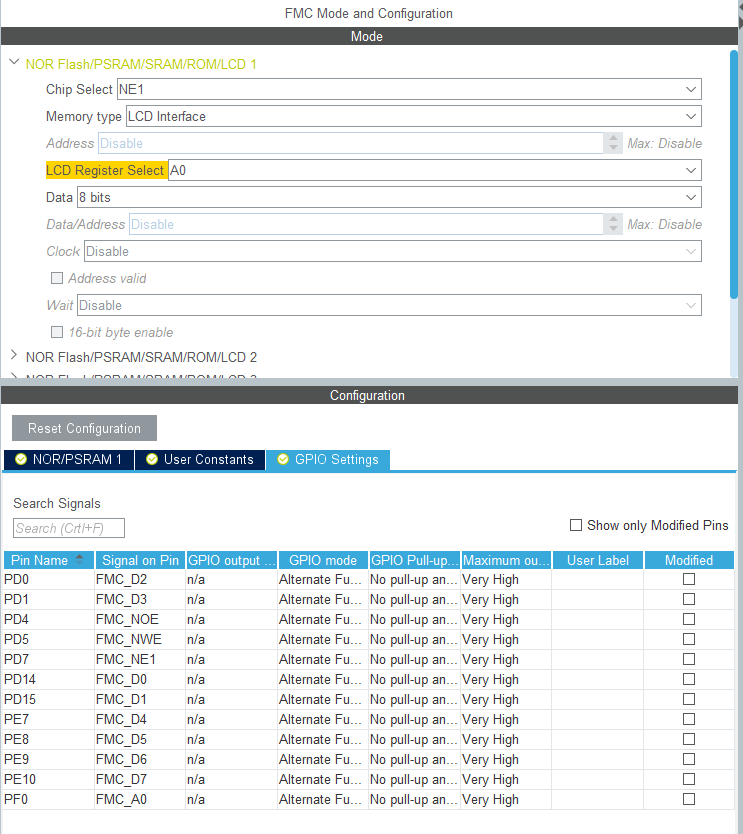

First of all I used CubeMX to configure my HW interface :
respecting A"N2790 TFT LCD interfacing with the high-density STM32F10xxx FSMC"
The generated code configured my FMC as :

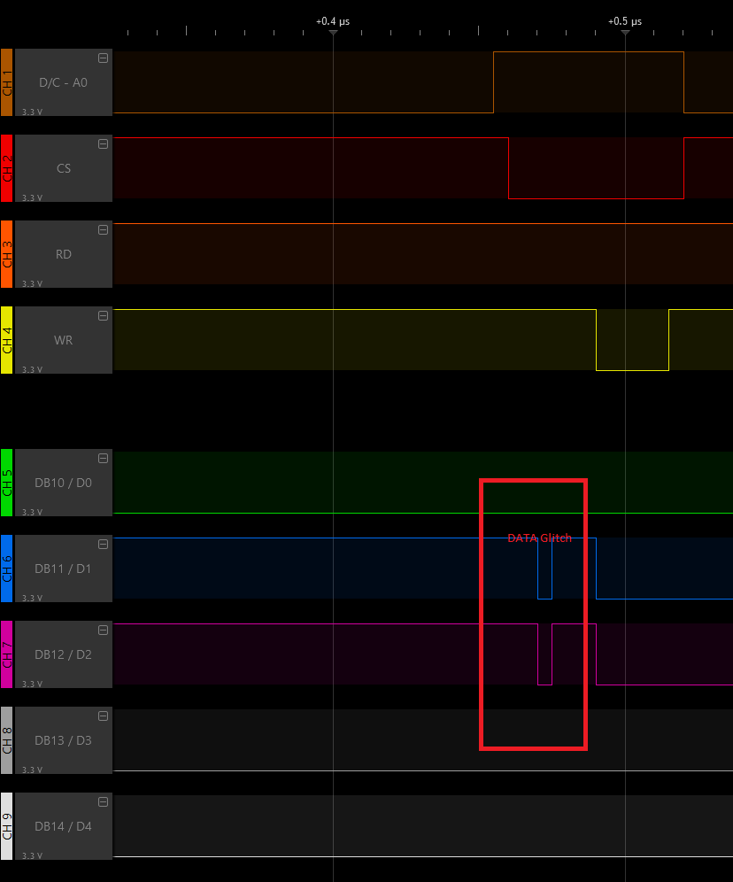

But its actually not works for some reasons. I measured each channel of my display interface and indeed I can see some glitch on the differents GPIO :0690X000009YuYmQAK.png

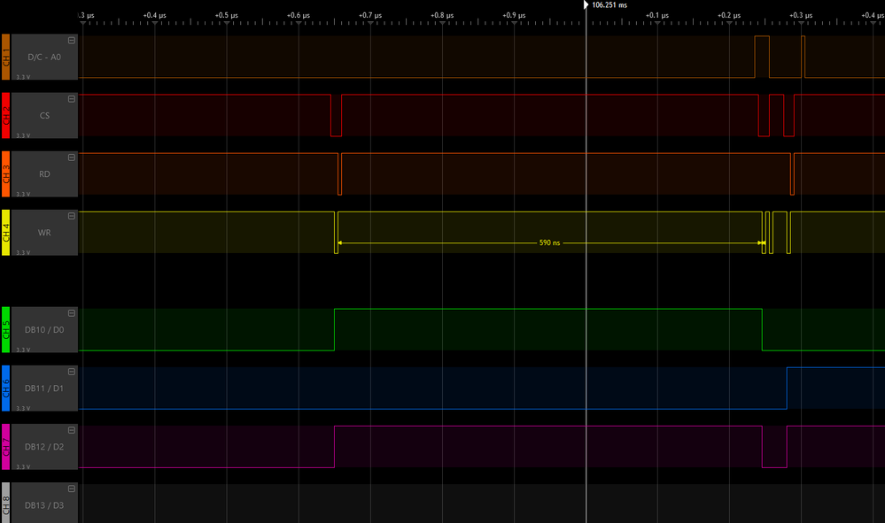

Why I got this glitch at first sent data ?. Which I got later on data :0690X000009YuZLQA0.png
Then, I tried to play with delay to works correctly and reduce delay between command and data :
Timing.AddressSetupTime = 1;
  Timing.AddressHoldTime = 1;
  Timing.DataSetupTime = 1;
  Timing.BusTurnAroundDuration = 5;
  Timing.CLKDivision = 1;
  Timing.DataLatency = 1;
But the result is very strange ... :
Delay is exactly same. But read GPIO changes.... I don't even try to read. Why I got this result ?
Finally, I got some questions about FMC mode :
How can I swap between 8080 or 6800 mode ? (I can't see any mode A,B,C or D which write with NOE toggle)

4 REPLIES 4
LGall
Hello again,

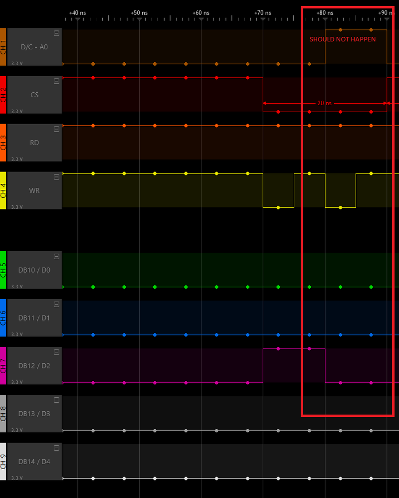

I successfully deleted the strange frame at start of transfer changing timing of AddressSetupTime to 0
Now my problem is that 2 write is done and Data/Sommand is changed. It shouldn't because I am trying to send only one command 0x040690X000009YvpyQAC.png
I don't understand why I got this.
Ok, well it's hard to tell without the context of how you're doing the writes, but it looks like it folded two writes, perhaps via the write buffering the Cortex-Mx.
Perhaps you should using some fencing commands/operations to separate the transactions?
The glitches described in your first post seem to be related to the data bus changing drive direction, or barrel shifting content, what happens prior to the rising edge of -WR surely should be irrelevant to the device that is latching on that edge?
You also don't specify what display/controller you are using, so it makes diagnosis rather hard, and whether you're actually looking at the right problem.
Hi again,
Thanks for your answer
I should put also these configurations.

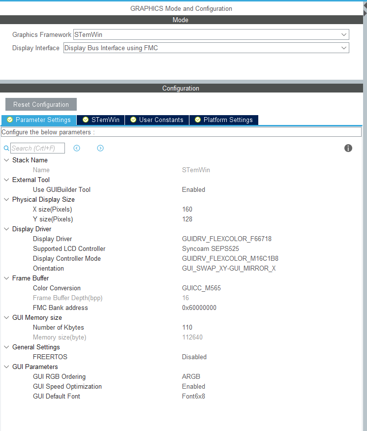

I am using an SEPS525 as Driver to control a display of 160*128 pixels.
I am using interface Intel 8080 with 8bits parallel for data actually.
first of all, I am just trying to write the register 0x04 (REDUCE_CURRENT) to 0x01 to power off my display.
Here is my code using to write the register and the data :
typedef struct
  __IO uint16_t REG;
  __IO uint16_t RAM;
}LCD_CONTROLLER_TypeDef;
/* The Bank address need to be entred by the USER */
#define FMC_BANK_BASE  ((uint32_t)       0x60000000  )
#define FMC_BANK       ((LCD_CONTROLLER_TypeDef *) FMC_BANK_BASE)
static void LcdWriteReg(U8 Data)
  FMC_BANK_WriteReg(Data);
static void LcdWriteData(U8 Data)
  FMC_BANK_WriteData(Data);
static void FMC_BANK_WriteReg(uint8_t Reg)
  FMC_BANK->REG = Reg;
static void FMC_BANK_WriteData(uint8_t Data)
  FMC_BANK->RAM = Data;
static void LCDController_Init(void)
// display off, analog reset
    LcdWriteReg(0x04); //At this moment, just try to send register command
    //LcdWriteData(0x01);
    osDelay(1);
As my current mode is Intel 8080 transfer is done at WR rising edge as described :
So indeed, its not a real problem to have a "glitch" before the transfert (means rising up of WR).
My real problem is the second post when it seems to the bus to turn arround but I don't ask to read (I only write a register with LcdWriteReg(0x04);
GGher
I think you declared the command and data pointers as uint16 causing 2 8 bit transfer.
