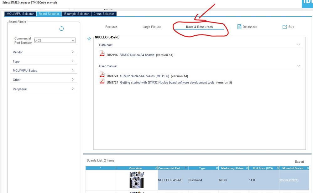

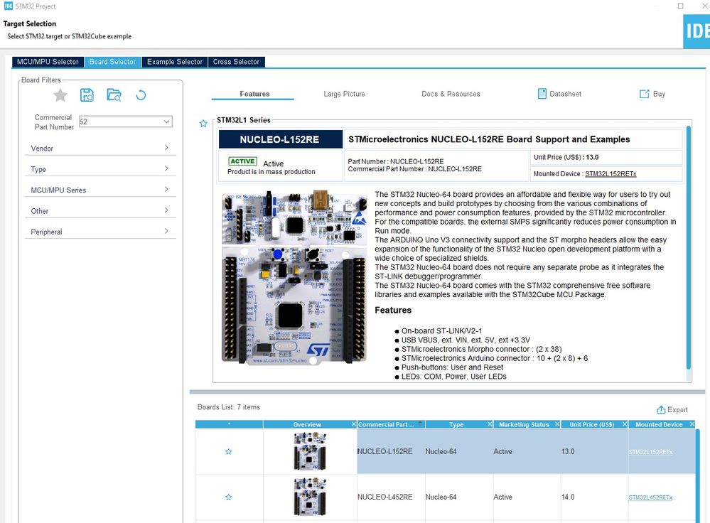

Well, for your question concerning the L452RE support, yes it's supported on CubeMX standalone and on CubeIDE too, if you can not find it on the MCU/MPU list , it's probably because of the version you are using now, so I recommend you to use the latest CubeMX/IDE versions (6.1.1 for MX and 1.5.1 for IDE).
As mentioned in the previous comment by @Cartu38 OpenDev​ ( and thanks for your detailed explanation ), you can find all linked document needed on site or even on the tool itself.
In addition to the example provided when you choose your Part Number under Boad Selector, you can find other examples of code with a detailed note for each project under your repository path: \Repository\STM32Cube_FW_L4_V1.16.0\Projects\NUCLEO-L452RE .

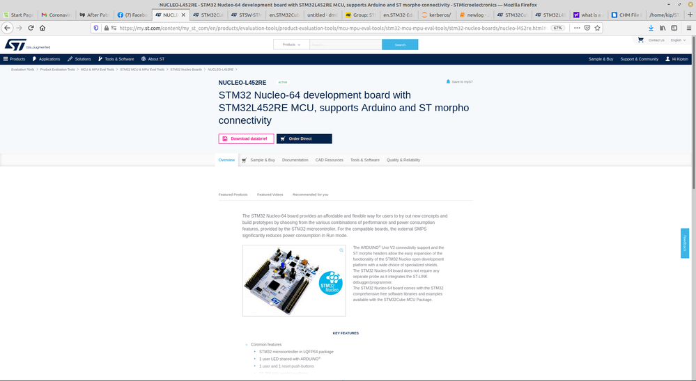

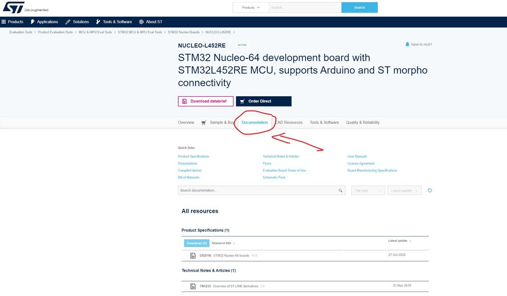

0693W000007CcUpQAK.pngI am trying to find the equivalent page to what you gave me. I searched the ST website for NUCLEO-L452RE there was this page that is not as helpful as yours looks for the other board.
What is the URL for the equivalent page for the NUCLEO-L452RE?
