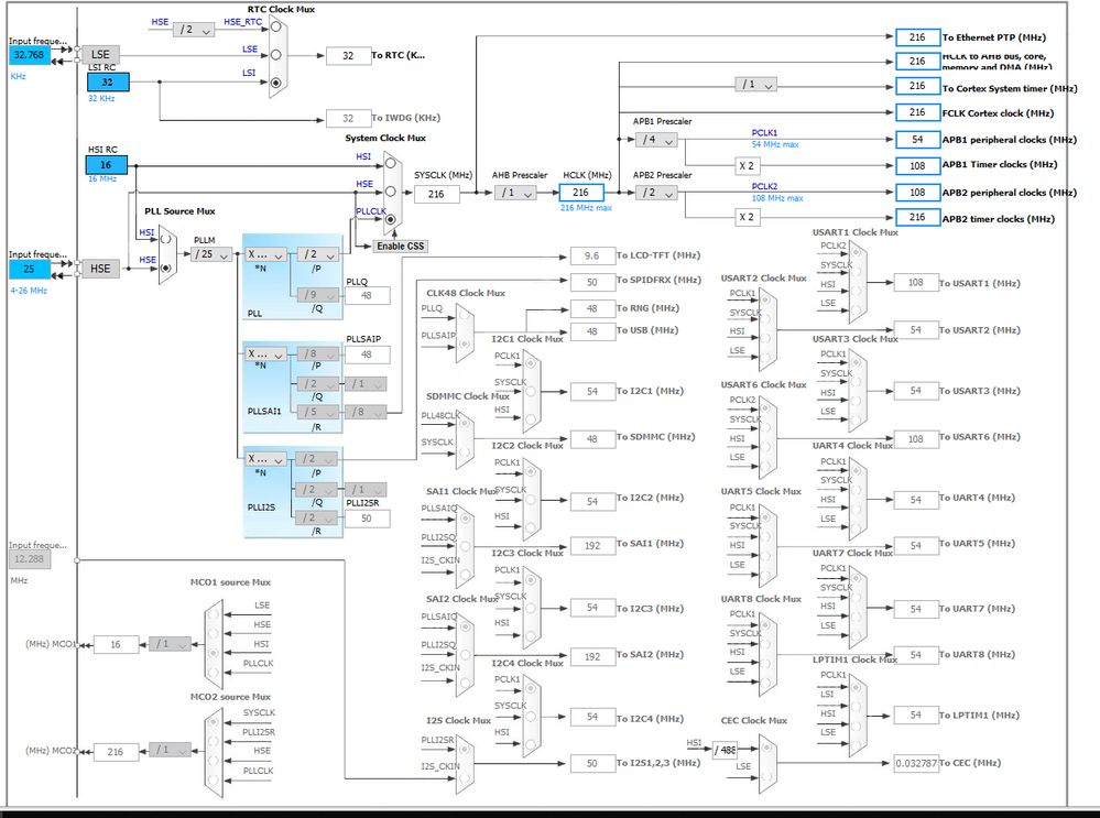

Hello, im generating default ethernet codes from CubeMX. im using freertos+lwip and i set static ip. All other lwip settings are default. My clock config:

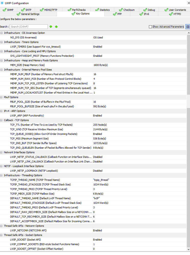

My default lwIP settings:

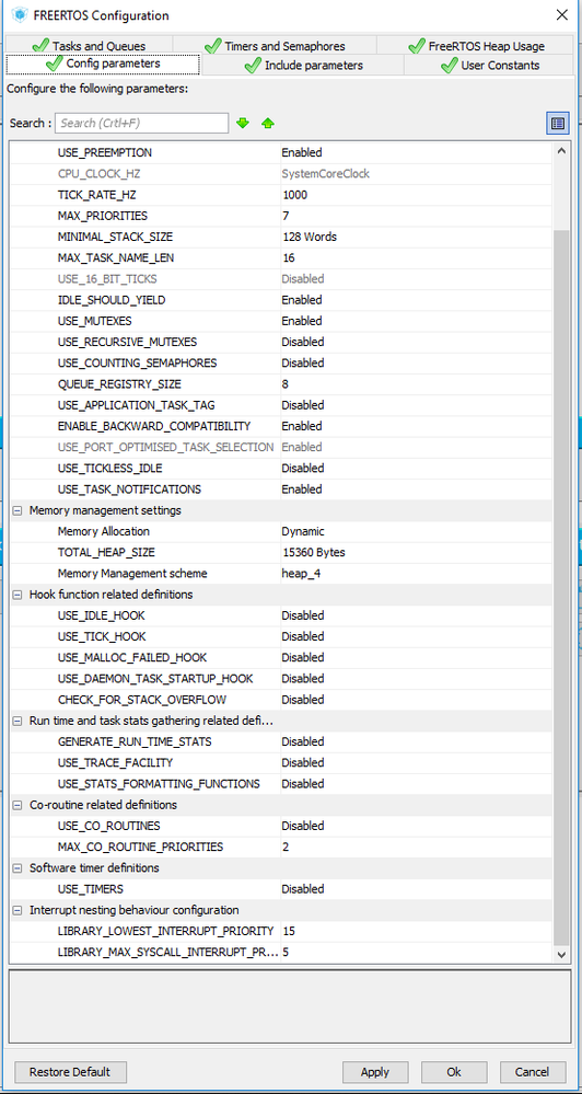

My default FreeRtos settings:

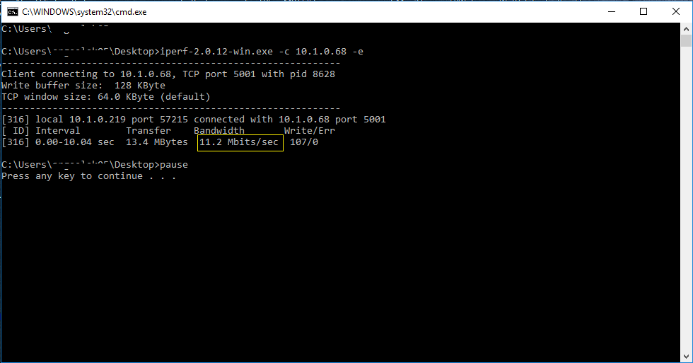

Test results are so bad. 11-12Mbits/sec.0690X0000060LPaQAM.png

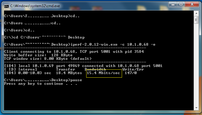

For nucleo board the speed is 15 Mbps
How can i fix and increase it ?

TCP_MSS is set to 536 bytes. I would increase it to 1460 bytes as the TCP header takes 20 bytes + IP header 20 bytes.
This would fit the Ehernet MTU of 1500 bytes.
The goal is to increase the packet size and reduce time spent on processing headers (to lower the number of packets).
Try to collect some Wireshark traces to prove what packet size is really used.
I have never tested the TCP_MSS value on the STM32. This is general approach to TCP based communication
Posted on July 02, 2018 at 07:13
I tried your advice. Its so logical. But there is no change. Unlike, it fixes the speed 191 Kbits/sec after some times. When i manually restart it reaches 15 Mbits/sec again. Is there a problem about buffers or etc. ?

CubeMx default settings allows 1426 bytes for TCP_MSS and i used this value. The below captures for 5.23 Mbits/sec iperf result on disco board.
