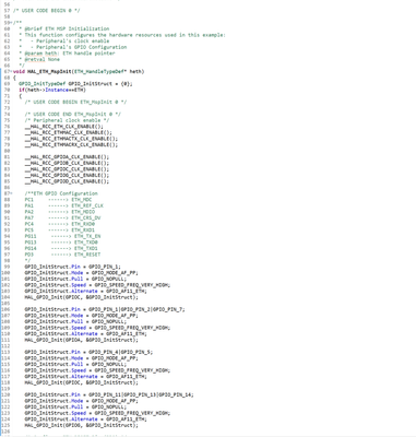

I finally worked  out, but i have encountered bigger problem.
i post my project on github : https://github.com/ABEGINNER-poor/dispenserBeneth.git
The reason why i can not successfully receive data ,is that the isr priority not be setted.
void HAL_ETH_MspInit(ETH_HandleTypeDef* heth)
  if(heth->Instance==ETH)
    /* USER CODE BEGIN ETH_MspInit 0 */
    /* USER CODE END ETH_MspInit 0 */
    /* Peripheral clock enable */
    __HAL_RCC_ETH_CLK_ENABLE();
    __HAL_RCC_ETHMAC_CLK_ENABLE();
    __HAL_RCC_ETHMACTX_CLK_ENABLE();
    __HAL_RCC_ETHMACRX_CLK_ENABLE();
    __HAL_RCC_GPIOA_CLK_ENABLE();
    __HAL_RCC_GPIOB_CLK_ENABLE();
    __HAL_RCC_GPIOC_CLK_ENABLE();
    __HAL_RCC_GPIOG_CLK_ENABLE();
    __HAL_RCC_GPIOD_CLK_ENABLE();
    /**ETH GPIO Configuration
    PC1     ------> ETH_MDC
    PA1     ------> ETH_REF_CLK
    PA2     ------> ETH_MDIO
    PA7     ------> ETH_CRS_DV
    PC4     ------> ETH_RXD0
    PC5     ------> ETH_RXD1
    PG11     ------> ETH_TX_EN
    PG13     ------> ETH_TXD0
    PG14     ------> ETH_TXD1
    PD3      ------> ETH_RESET
    GPIO_InitStruct.Pin = GPIO_PIN_1;
    GPIO_InitStruct.Speed = GPIO_SPEED_FREQ_VERY_HIGH;
    GPIO_InitStruct.Alternate = GPIO_AF11_ETH;
    HAL_GPIO_Init(GPIOC, &GPIO_InitStruct);
    GPIO_InitStruct.Pin = GPIO_PIN_1|GPIO_PIN_2|GPIO_PIN_7;
    HAL_GPIO_Init(GPIOA, &GPIO_InitStruct);
    GPIO_InitStruct.Pin = GPIO_PIN_4|GPIO_PIN_5;
    GPIO_InitStruct.Pin = GPIO_PIN_11|GPIO_PIN_13|GPIO_PIN_14;
    HAL_GPIO_Init(GPIOG, &GPIO_InitStruct);
    /* Configure ETH_RESET Pin (PD3) */
    GPIO_InitStruct.Pin = GPIO_PIN_3;
    GPIO_InitStruct.Pull = GPIO_PULLUP;
    HAL_GPIO_Init(GPIOD, &GPIO_InitStruct);
    /* Reset PHY */
    HAL_GPIO_WritePin(GPIOD, GPIO_PIN_3, GPIO_PIN_RESET);
    HAL_Delay(10);
    HAL_GPIO_WritePin(GPIOD, GPIO_PIN_3, GPIO_PIN_SET);
    HAL_Delay(100);
    /* USER CODE BEGIN ETH_MspInit 1 */
    /* Configure ETH interrupt */
    HAL_NVIC_SetPriority(ETH_IRQn, 6, 0);
    HAL_NVIC_EnableIRQ(ETH_IRQn);
    /* USER CODE END ETH_MspInit 1 */
but as you can see , the generator did not give me the right code ,and i have to set in
the user area on my own .but something even more strange things happend, these configruation
can still affect the running job ,when i configure the eht isr to 6,
below configLIBRARY_MAX_SYSCALL_INTERRUPT_PRIORITY ,it dose worked.but when i check out
the HAL_ETH_MspInit ,the code still be HAL_NVIC_SetPriority(ETH_IRQn, 5, 0); then i delete
this line and reupload ,the eth interrupt was not working, so i deeply confussed.

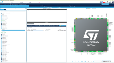

Hello @crazy88
I have reviewed your IOC file and noticed that you enabled both ETH and LWIP without selecting a PHY driver
In this scenario, since the configuration is incomplete (specifically, the Platform Settings under LWIP), CubeMX will not generate the necessary GPIO initialization code for Ethernet, which is the expected behavior.
As a workaround, you copied the initialization code that CubeMX generated when only ETH was enabled. I assume that, in this configuration, the Ethernet interrupt priority was set to 5  then you  placed this code in the user section 0 of stm32f4xx_hal_msp.c.
Is that how you proceeded?
THX
Ghofrane
i'am sorry to reply so late,i' ve been busy these days. and,yes,that's exactly what i did.I put these code in the user section of stm32f4xx_hal_msp.c. I want to know which function of whinch file for the generator generate HAL_NVIC_SetPriority ,thx;
