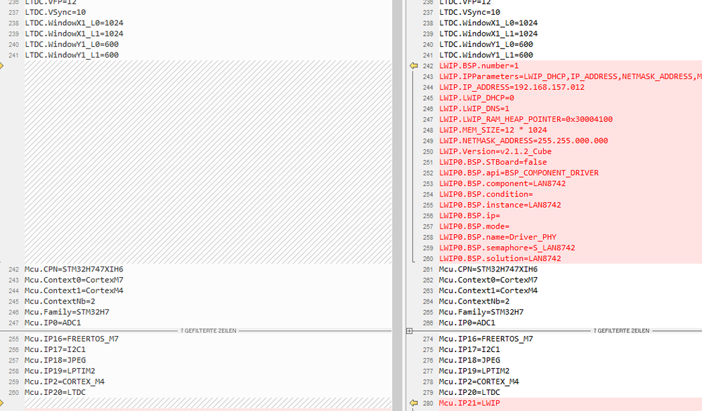

Opening an H7.ioc file FW_H7 V1.11.1 in CubeMX 6.11.1 containing a LWIP secition and upgrade to FW_H7 V1.11.2 removes LWIP section.
Cheers!
- open the attached .ioc file in CubeMX 6.11.1
- migrate to FW version FW_H7 V1.11.2
- do not change anything and save the .ioc file
- observe missing LWIP secition in .ioc file

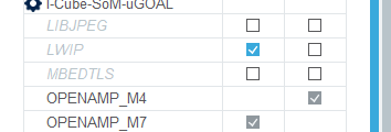

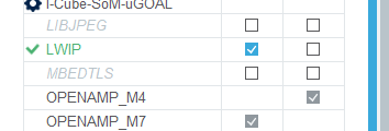

- observe the missing / not found LWIP files in CubeIDE
pre uppgrade FW_H7 V1.11.1
post upgrade FW_H7 V1.11.2
LWIP is not availabe for single core (M7 / M4)

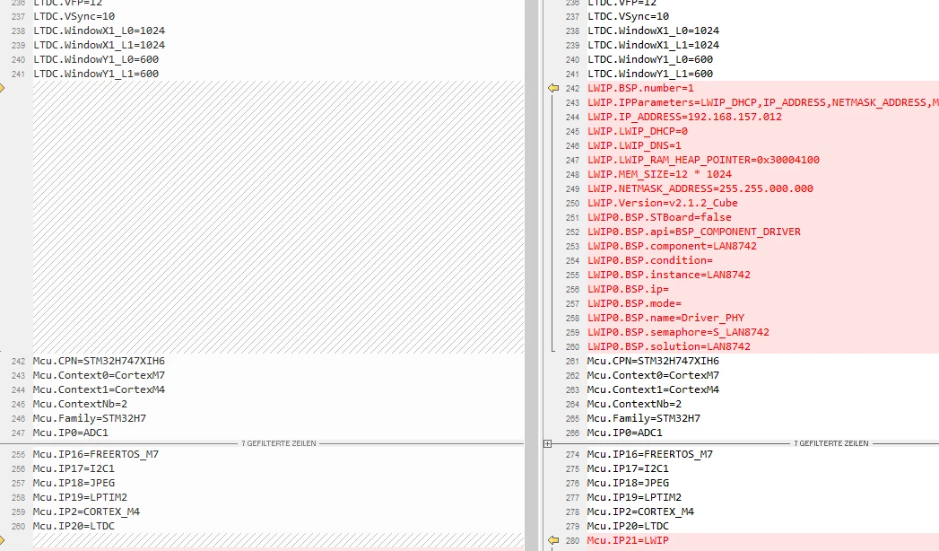

delta of .ioc
