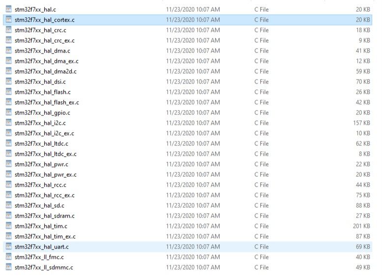

Attached is a CubeMX 4.26.0 project file (.IOC) with custom settings for the SDMMC1 interface (SDMMC1 hardware control ENABLED, among many other things). Yet when I generate code, for an Atollic project (or any kind of other project), and look at the HAL_SD_Init_Card() function in "Drivers\STM32F7xx_HAL_Driver\Src\stm32f7xx_hal_sd.c" I see SDMMC_HARDWARE_FLOW_CONTROL_DISABLE... As a matter of fact, none of my custom interface configurations are in any of the HAL files... It looks like all the files are unmodified, just copied from the CubeMX repository (modified data is over 2 weeks ago for every file)...

Most HAL driver files (such as stm32f7xx_hal_sd.c) don't change based on your configuration. Initialization functions in main() and in stm32f7xx_hal_msp.c will change.
SD cards are all brought up in the same configuration. Not sure what this particular bit does, but my guess is HAL doesn't support it, or doesn't support it well.
‎2020-12-09 2:30 PM
Thank you, I was looking in the wrong spot.. :) trying to get this SDMMC1 interface to work with a Board and SD Card that works when I use the "STM32Cube_FW_F7_V1.15.0\Projects\STM32746G-Discovery\Applications\FatFs\FatFs_uSD" example, but no luck so far...

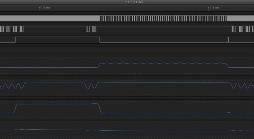

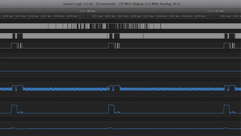

But, I still don't understand why my SD Card interface is not working (looks like the clock is not functioning correctly):
signal 1 is SDMMC1 clock
signal 2 is SDMMC1 CMD
signal 3 is SDMMC1 data bit 1
here is a bus capture of this project not working:
here is a bus capture of working interface:
any help will be greatly appreciated!!l
‎2020-12-09 6:11 PM
In your original post, you said you were generating your own code with an IOC file. In your later post, you said you were trying to get the "FatFs_uSD" example working. I would stick with one or the other. I think the "FatFs_uSD" example from has a better chance of working than whatever CubeMX is spitting out.
