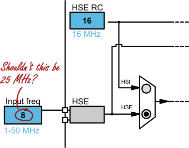

The Nucleo_F767ZI board has 4 crystals onboard:
  • X1:     8 MHz      connected to the JTAG-chip on the STLink
  • X2:     32 kHz    connected to STM32F767ZI for real time clock
  • X3:     Not soldered
  • X4:     25 M
    H
    z    connected to STM32F767ZI for HSE input clock
From this information, it is only logical to conclude that the 25 MHz crystal is connected to HSE input of the microcontroller. However, CubeMX fills in 8 MHz by default for the Nucleo board. It looks like that is plain wrong:

waclawek.jan
Posted on December 14, 2016 at 19:45
The 25MHz crystal is not connected to the 'F7, due to the default setting of solder bridges. By default, the HSE is fed from the MCO output of the STLink mcu (and that's 8MHz). Read 6.7.1  OSC clock supply chapter in the Nucleo144's manual,

Posted on December 14, 2016 at 19:52
Thank you Jan,
That's really helpful!
I read in that paragraph '6.8.1 OSC clock supply' that with some solder bridges you can connect crystal X3 (which is not soldered on the board yet) to the STM32F7xx chip.
Anyway, what is the 25 MHz crystal X4 meant for? Perhaps the ethernet?
Thanks a lot for your helpful answer :)
Posted on December 14, 2016 at 20:59
X4 clocks the Ethernet PHY chip, it is not directly connected to the STM32, comes back in via the RMII clock.
The User Manual provides a schematic.
The ST-LINK's F103 uses it's PA8 (MCO) to export its internal clocking, and is clocked externally via an 8 MHz HSE crystal. The F7 would take this as an HSE-BYPASS type source, like it would with a TCXO or other oscillator source.
