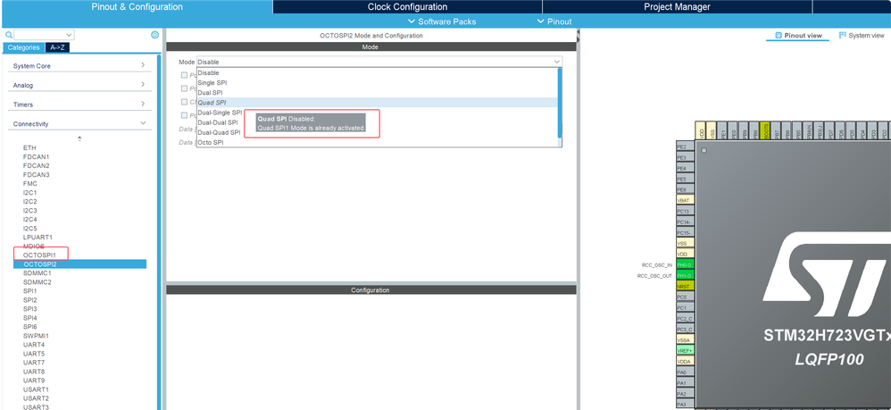

H723 - CubeMX v6.15 cannot utilize the Quad SPI function of OCTOSPI
BJX
As mentioned, in order to rule out the interference from the existing project, I created a new blank project. However, it still didn't work. This issue was not present in the previous version 6.13.
As shown in the above picture, I have disabled spi1 but still cannot enable the quad spi mode of spi2. Please provide a solution as soon as possible, or please inform me how to roll back my project version to 6.14 or earlier. The project is urgent. Thank you.@

Hello @BJX ;
The issue is fixed in STM32CubeMX 6.16.0 version.

Hello @BJX and welcome to the community;
First of all thank you for posting.
Similar issue is reported here.
Internal ticket number is reported : 213708 (This is an internal tracking number and is not accessible or usable by customers).
I apologize for any inconvenience.

Hello @BJX ;
