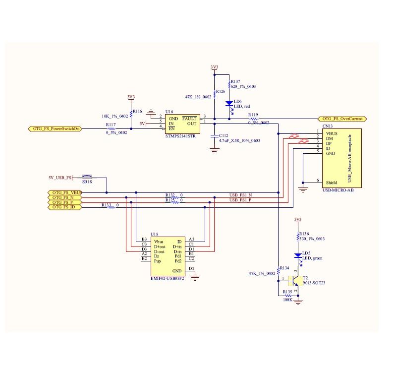

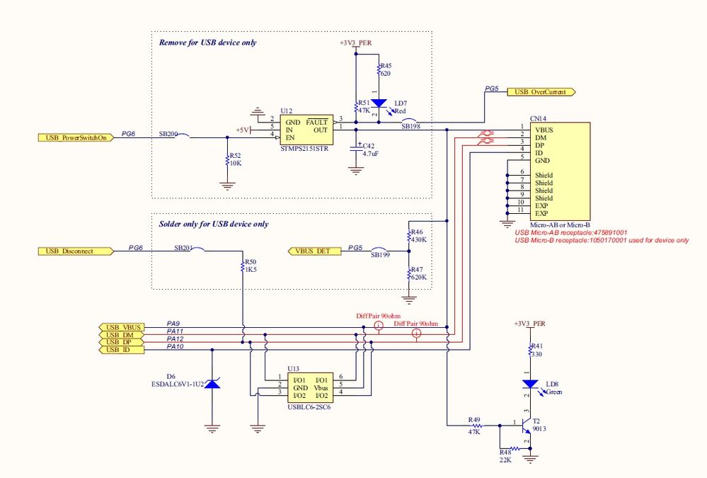

2021-03-26 4:50 PM
Hello, ST help desk:
10 months passed, this issue is still there in F7_FW_1.16.1, I spent two days to check and find this bug. Please fix it soon.
This issue is come form your boards design, as below pictures, some boards' VBUS control use Low enable ((32F746GDISCOVERY) and some use High enable(Nucleo-F767ZI). They are both F7 series but use different VBUS control chip.
