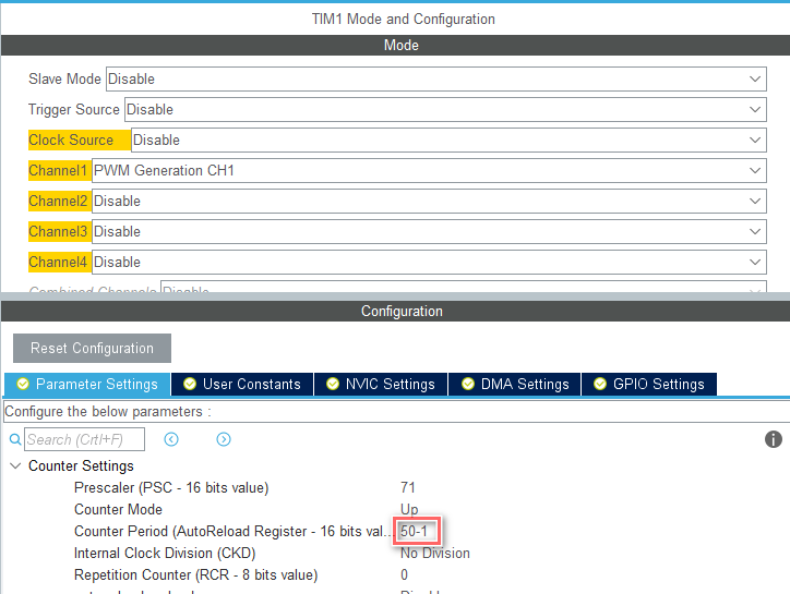

using stm32cubemx 6.0 to make a project for STM32F103RC TIM init.
the configuration as follow pictures.

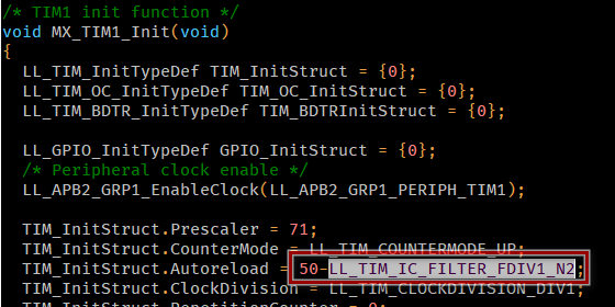

the code be generated as a wrong as follow.

Hello Bruno Hu,
I can't reproduce the issue, could you please share your .ioc file for further check?

Hello Khouloud Othman,
Pls look .ioc from the attached file.
Hello @Bruno Hu​,
Thanks for your feedback.
This will be internally checked.
