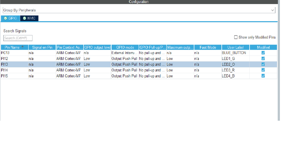

Adding User Label in CubeMX, and regenerating code, CubeIDE doesn't add appropriate #define resulting in undeclared errors. Is this the design behavior?
HGran.1
Shouldn't CubeMX 6.01 create the #defines that coorespond to newly added User Labels in an existing project ?
Of course it works if I add the User Labels as #defines manually.
If this is the expected design behavior, please let me know...

JSchn.4
Hi there,
I had the same problem. The reason for me was pretty simple.
Since I am working on a dual core, I had to assign a "Pin Context" (M7 or M4).
After having assigned that, it worked as expected.
Here is a screenshot of the configuration
0693W000008GD9FQAW.pngHope it helps you too!
Johannes
This worked for me.
Thanks!
