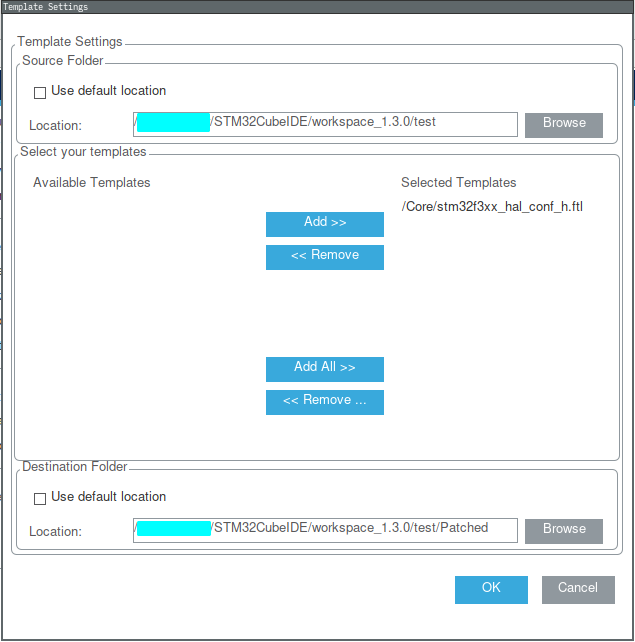

I've figured out a workaround for this and since I suspect that this might be applied to other issues as well, I'm posting it here.
The idea is to use a user template (which is a FreeMarker template with alternate square bracket syntax) to wrap specific blocks of the auto-generated header file into USER CODE sections.
This allows user modifications within that block to survive code regeneration. Other things could be done as well.
You create a [original file to replace]_[extension].ftl with the following content

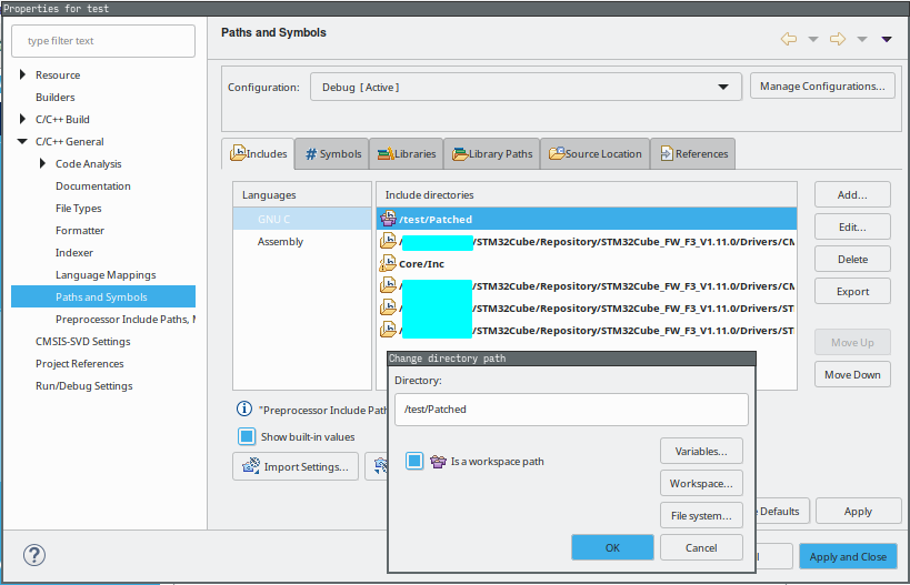

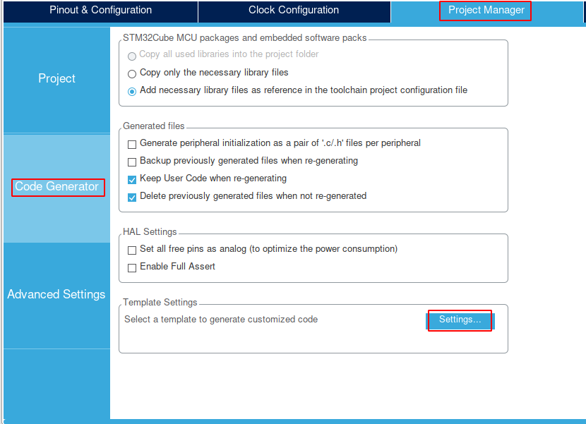

You add this as a user template (do note that all user template files are generated to the same destination folder)
And since the original file is still generated, you need to manage the conflict somehow
- original source files can be excluded from build
- original header files can be overridden by moving the user modified ones earlier in the include search path
Also note that, if there are any issues with the template file, the output file might be empty, or might not even be generated.
