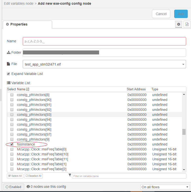

Is there a good way to view structured data? I have a global variable of structure data type, I was not able to view any fields of this struct except of specifying memory address directly.

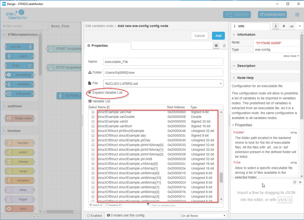

Did you check the "Expand Variable List" checkbox in the "exe-config" node panel (as shown in attached picture)?
It should normally show the content of data structure and the arrays.

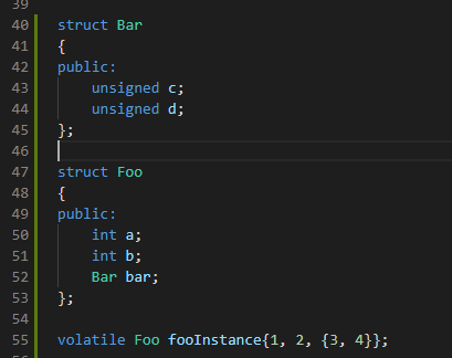

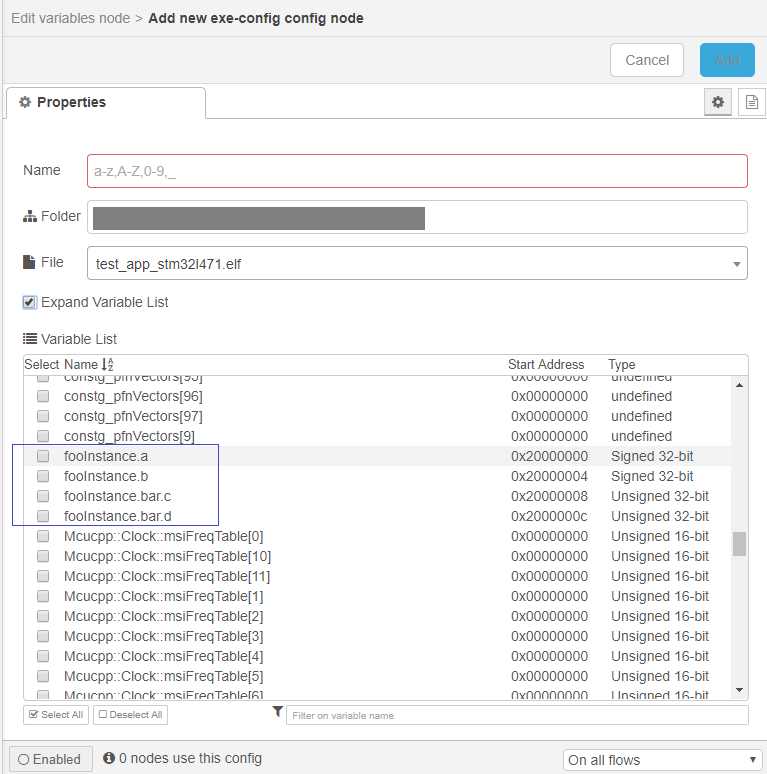

OK, I got it. I'm using C++. For some reason this feature works only for 'structs' but not for classes.
Same code compiled using arm-none-eabi-gcc 9.2.1 i C++ mode. If I use 'struct' keyword.
It looks OK.

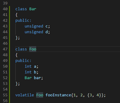

However is I use 'class':0693W000000V6QHQA0.png
No fields of class are visible:
So this question should be re-classified as "Expand variables does not work with classes".
Thierry
Senior
Dear Kchiz.1,
The C++ classes are actually not supported by our executable parser. We will look at this support in a futur release.
