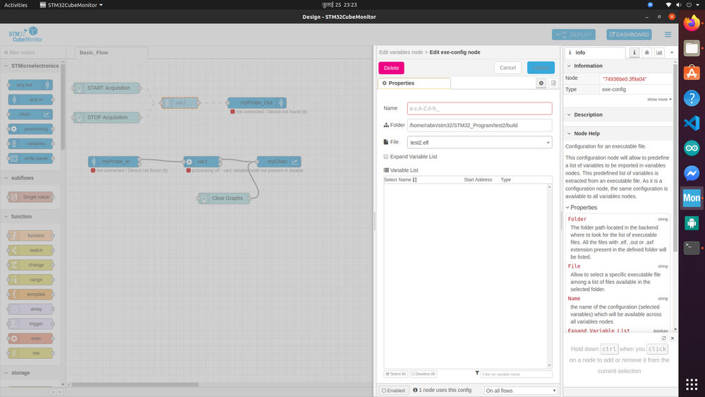

I have installed stm32cube monitor in ubuntu 20.04 but it is not working properly.I have put .elf file link in variables option but the variable are not show in variable list. how to slove this problem?

Hello RG,
We have answered a similar issue on following link:
Can you check if libncurses5 is installed on your ubuntu version.
thanks and regards
Richard

‎2020-08-29 5:33 AM
Same problem. Fixed with
sudo apt install libncurses5
