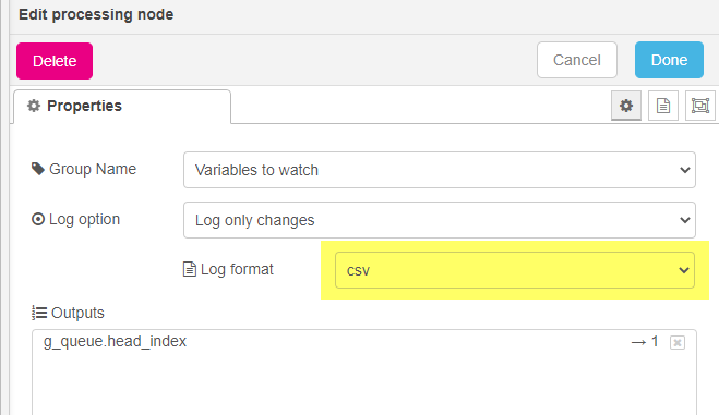

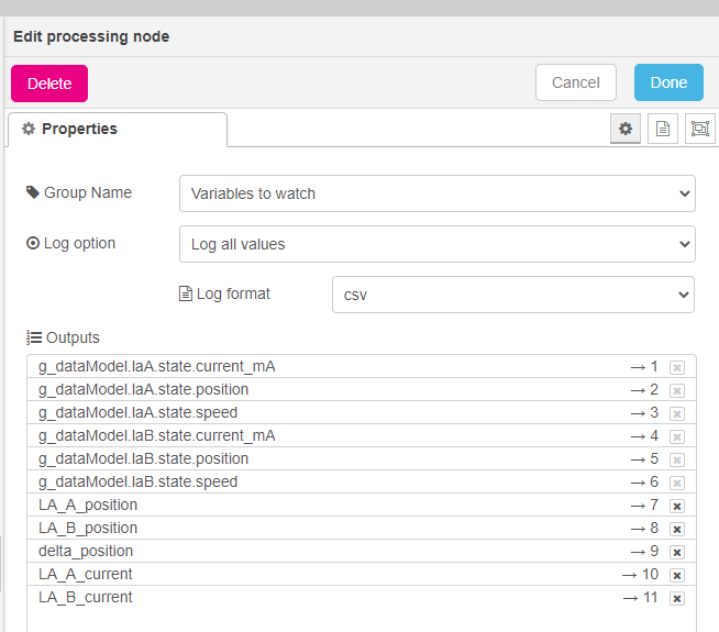

I'm trying to log my data in a .csv file, using the STM32CubeMonitor v1.4.0.
I'm configuring my ST processing node as follows:

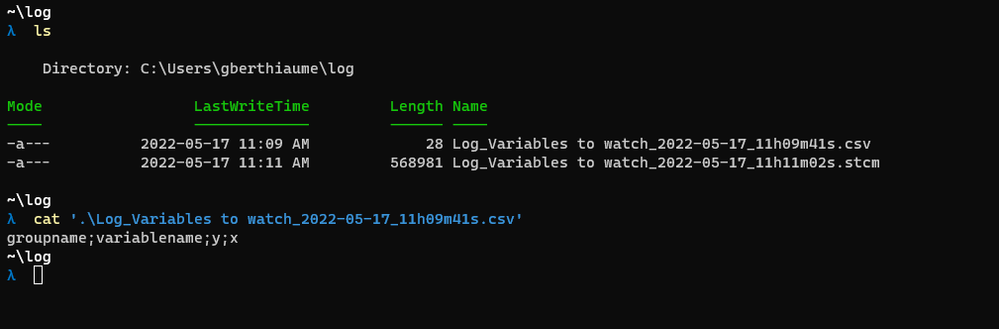

Sadly, it produces .csv with no data in them (see next screenshot).
I also tested the same setup with the .stcm, and it worked.
Am I missing something? Or is this a known bug?

GBert.2
Senior
Hi @Richard.Chvr​ .
I checked again today with
  • My computer
  • My colleague's computer
  • My client'S computer
Everytime, STM32CubeMonitor produce empty csv file.
I'm not sure what's the problem.
Here is some info:
STM32CubeMonitor: version 1.4.0
OS: Windows 10 Pro [64-bit]
ST-Link: V3-E (SWD, 24000kHz)
ST-Link Firmware: V3.J9
Let me know If I'm missing something.
Thank you.

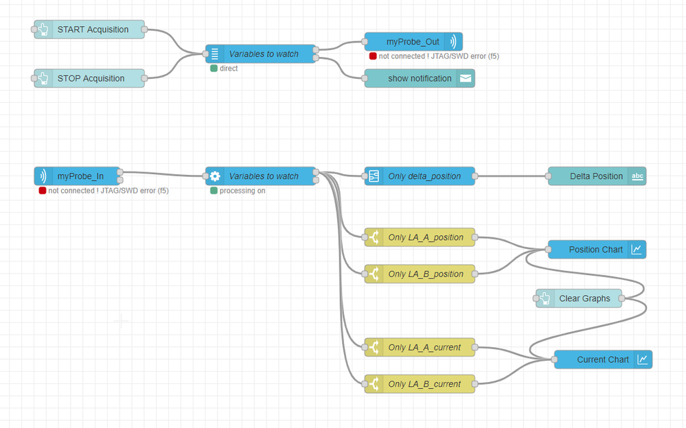

Richard.Chvr
Hello
You're flow and configuration looks OK to me, quite strange behavior...
You can duplicate your processing node, one using stm output , other csv and check. If stm file is not empty and csv is, there's an issue on ST side to be investigated.

Hello @GBert.2​ ,
The problem comes from the '.' character in the variable name, will be solved in the next release.
Regards
