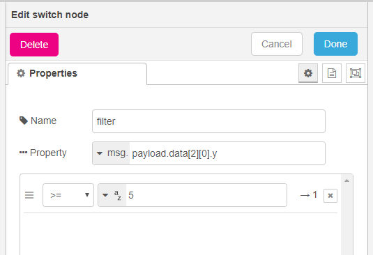

One short trick is to use a switch node between your acq in node and your processing node.
No need to define trigger in this case, you will "manually" filter data .
You need to know the position of the variable you want to use as trigger , and then in the switch node you need to define the following ( in this exemple i want only data where the third variable is >=5 :
Hope it will help.
Landry
2020-04-16 10:07 PM
Hi Landry,
That sounds promising.
I couldn't figure out how to determine/discern the structure msg.
Only place i could see some information was in the log file:
{"groupname":"STAccelData","variabledata":[{"y":1,"x":1587097378157}],"variablename":"DeviceOrientation"}
{"groupname":"STAccelData","variabledata":[{"y":-880,"x":1587097378160}],"variablename":"StAccelDataX"}
{"groupname":"STAccelData","variabledata":[{"y":-353,"x":1587097378160}],"variablename":"StAccelDataY"}
{"groupname":"STAccelData","variabledata":[{"y":16479,"x":1587097378160}],"variablename":"StAccelDataZ"}
but how to map this to say something like msg.payload[row][col].y in the filter block?
I tired blindly assuming msg.payload[0][0].y is the corresponding location for DeviceOrientation but that didnt work unfortunately.
2020-04-17 12:33 AM
HI @VOlet.1
You can have the structure message in the help of each node (" info" sheet in the right panel of the design view).
You can also add a debug node after any output to see the messages exchanged in the debug panel ( "debug " sheet in right panel of the design view ).
The mapping of variables is simple, it's the order you see in your variables node or processing node.
I can see in the message you sent me that you forgot the .data in the element to filter.
So in your case if the "DeviceOrientation" is at the first place it should work with the filtering on msg.payload.data.[0][0].y >= 2.
Thank you
Landry
2020-04-17 03:19 AM
Hi Landry,
That was it, after add the missing .data it's working perfectly.
I was also able to figure out the contents using the debug block.
Thanks a lot, it was very helpful!
