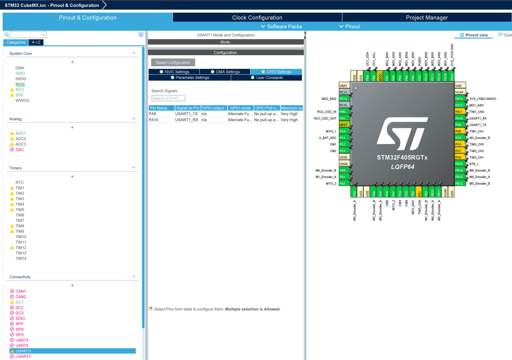

In the STM32CubeIDE I have several yellow triangle warnings. I have read in some other posts this is just that some features of that cannot be enabled due to your current settings. However, in my case I have very many and on all Timers. I am struggling with the UART connectivity and maybe thought these triangles could cause it.
See image below:
Thank you
AScha.3
 These triangles could cause - nothing !
Its just showing, that here (yellow) no more all functions can be used, because pins already used for other function.
So you have used almost all pins on this chip...not much still "free" . That it shows you.
If you have 100% used all pins , dont cry about : here is something wrong, just take a case with more pins .

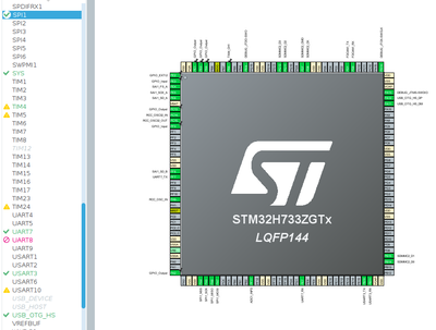

See here on xxxZ , 144 pins, still many free pins = functions to use. Just a view yellow warnings:

You are understanding very well the purpose of the yellow triangle. Put the Cursor on those triangle and you will receive a pop-up with the raison behind the fact that some features of that cannot be used.
