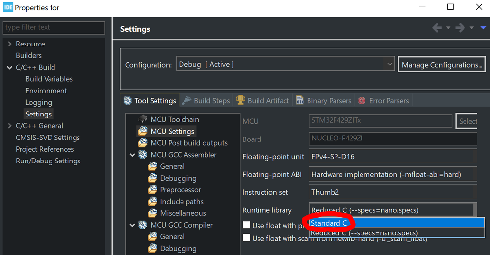

I trying to use sprintf to display some values for debug purposes. I am getting wrong results in STM32CubeIDE v1.5.0 but it is working with an online gcc compiler.
The code is in a function and for now I'm re-assigning the values inside the function for debug. Here is my code in STM32CubeIDE:
void log_data(int16_t u, int16_t y, int64_t z, int16_t indx )
	u = 50;
	y= 100;
	z= 4351234;
	indx= 0;
	static char msg[48];
	sprintf(msg, "%d %d %lld %d \r\n>", u, y, z, indx);
	HAL_UART_Transmit_IT(&huart3, (uint8_t *) msg, strlen(msg)); // &huart3 &hlpuart1
The result displays:
50 100 ld 4351234

Note the STM32CubeIDE code displays characters 'ld' in the 3rd position of the output and the last value (indx) which should be 0 is not displays.
If I change z to 9876543210 the online compiler gives the correct result but STMCubeIDE prints the following: 50 100 ld 1286608618
What can I do to print a 64-bit int value?
Thanks,
Brian
STM32CubeIDE uses a reduced library by default in order to reduce code size, as it's usually preferred for embedded development. Part of this tradeoff is dropping support for long long ints in printf-type functions.
Change the runtime library from reduced to standard.

Excellent! Thank you so much for this knowledge. I'll take a look at this tomorrow and keep the code size in mind.
