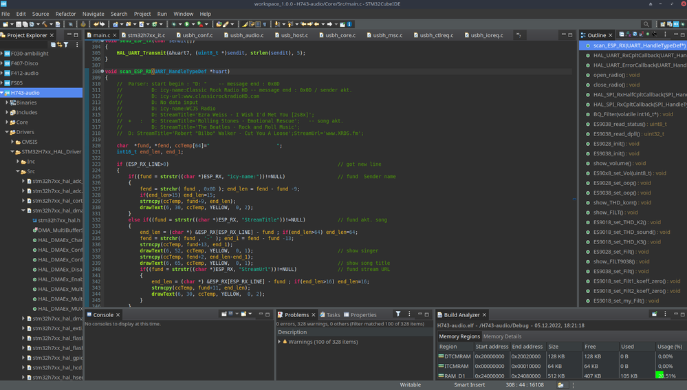

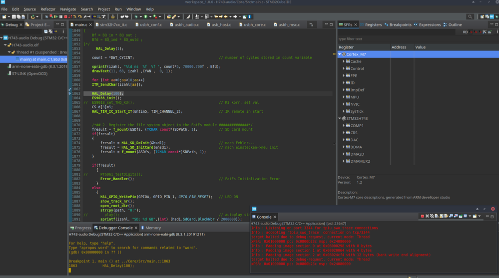

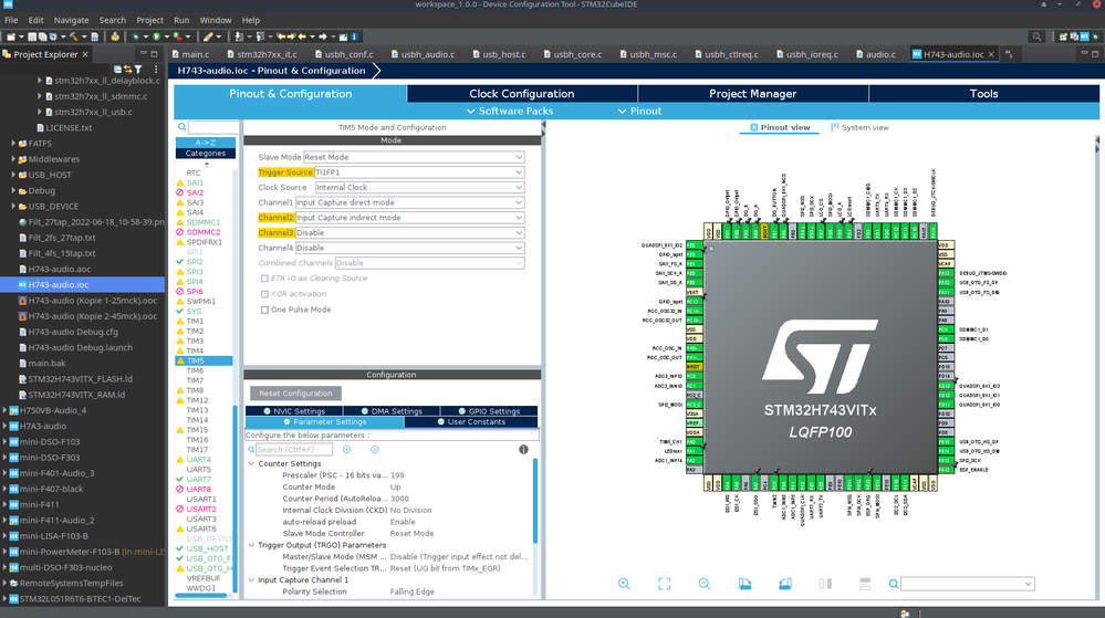

Hello, i have STM32CubeIDE running since version 1.0.0 running at work on Win7 PC and at home on Linux Mx18 PC. Behavior was different from beginning ; ide (eclipse) has 3 views: c(edit) , CubeMX and debug. on Win most time switching from C edit to chip MX edit, view changed not correct, just CubeMX starting in a black window in center, closing and starting again gives chip view, but in small center window; need click on MX view, to get it, like i set it (full size).
0693W00000WKUFsQAP.pngon Linux was perfect: switching to debug or MX , changed the whole windows setup as i set it, always.
and go back, finish debug, switched back to editor view with all settings i made perfectly.
until - something happened. ide hang up...restart, seem ok, but since then: similar to Win PC , swichting between views not complete, sometime "forget" to switch, suddenly new window arrangemant , can "restore" , then most time (!) correct, as before.
so can work with this behaviour, but giving me the feeling, something wrong now.
just show, how i setup views:
