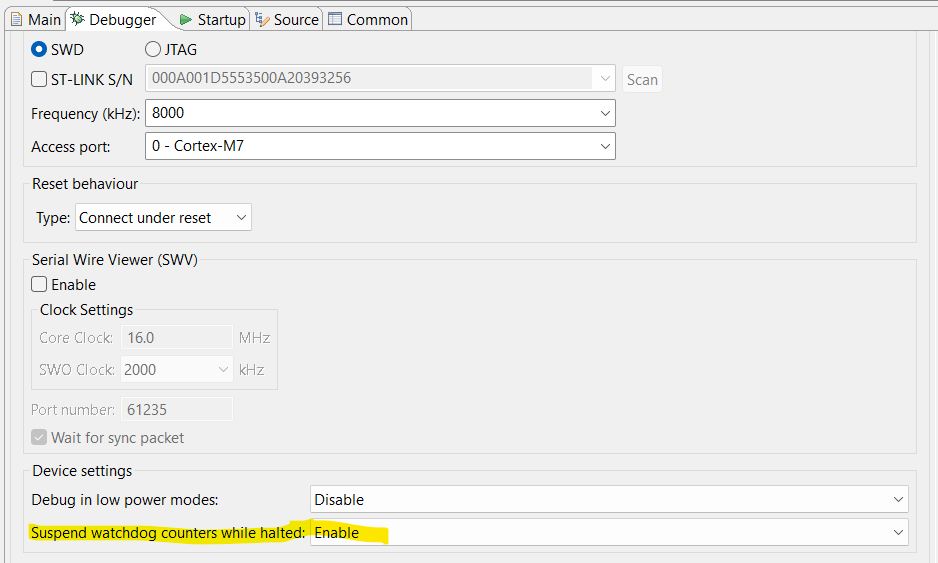

While trying to debug the program I get the following error:
CM4 Failed to read all registers
FAILED to REGISTER Values from the target
What should I do?

‎2022-08-08 3:15 AM
I managed to solve the problem with enableing suspension of watchdog in debug settings.

Can you share the SystemClock_Config function
