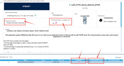

Sorry I have to come back to this post for a new issue in compiling C++ code.
The C++ code compilation is all right now in my previous test project which is my first CubeIDE project. Then I was trying to use that method to do the same thing in the example project (Nucleo-STM32F767ZI) :  LwIP_HTTP_Server_Netconn_RTOS
However, I found unexpectedly I don't get the option of "Convert to C++" when right click on this project in Project Explorer.
When I  right click on other projects, I could see this option or option of "Convert to C" for the one I already converted to C++.
I also did a new import of this example, and the result does not change.
Any solution for this?
Regards
Chao
I did this example import again more carefully, and found the following:
It looks like that it's not an STM32CubeIDE version example, is not compatible with CubeIDE,  and is not configurable in CubeIDE (actually there is no .ioc file),   so is it possible to convert this example from other toolchain/IDE (say MDK-ARM) to CubeIDE?
It would be highly appreciated if someone could share a link of this conversion.
Regards
Chao
See here:
https://wiki.st.com/stm32mpu/wiki/How_to_move_from_SW4STM32_to_STM32CubeIDE
Can also just try "Import ac6 System Workbench for STM32 Project" without the extra steps.
Pavel A.
In CubeIDE, do "Import"....  then in the dialog select "Import STM32CubeIDE example".
This option is slightly better than "Import ac6 System Workbench..." as the import tool has more clues. Internally, of course, it will use the SW4STM variant of the example, so all advices on importing from SW4STM and fixes after  the import, apply. See also here.
