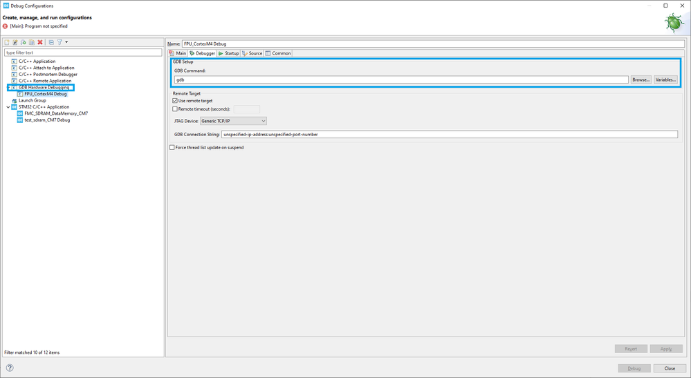

I am using STM32H745BIT6 controller on my custom board and using
STM32CubeIDE ver 1.11.
I plan to use the PE micro universal debugger and ST link both alternately to program/Debug the controller.
I already had setup the ST link in STM32CubeIDE v1.11 and was able to debug the controller.
I used this link below to install debug configuration for PE micro in STMCubeIDE
https://www.pemicro.com/blog/index.cfm?post_id=189
After the installation is complete the PE micro debug configuration is visilbe in debug config in STM32CubeIDE but ST link configuration is not visilbe which was visible earlier.
How do I add the ST link debug configuration now?
Please see attached debug config snapshot
Thanks

Hello @Community member​
First I want to inform you that we are facing an issue with installing plugins. You can check this post related to the issue.
Our developers are working on the problem and the fix will be available as soon as possible.
This could cause problem when installing the Pe Micro plugin.
I can mention an other solution you can adopt: Go to debug configuration and select "GDB Hardware Debugging"
In this case you should set the debug command line manually.
Kind regards,
