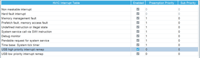

Using CDC USB on STM32G4 FW version 1.5.2, Win10 with default VCP driver.
When calling CDC_Transmit_FS() from main() it will work for a few seconds and then hang indefinitely when TxState is never reset to 0. Others have had this issue (see: here, here) and reported the solution being interrupt priority. This is how I have my interrupts set:
Which seems right to me, nothing could overwrite the USB Tx interrupt - but the issue persists.

Hi @eot105
TxState should be reset after the transmission is complete. Maybe continuously calling CDC_Transmit_FS in the main loop without any delay can overwhelm the USB stack. Introduce a delay or a condition would help to control the transmission rate.
Pavel A.
Calling CDC_Transmit_FS in the main loop continuously without delay is not nice but by itself It should not "overwrite TX interrupt". It should check the internal state and return BUSY until previous transfer goes thru. So it looks like a sync problem or stack size too small or corruption of variables. For best results, consider other USB library
