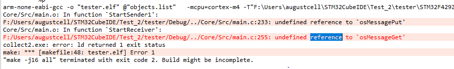

Hello everyone,
So I am currently following: https://www.youtube.com/watch?v=Iyc0vk4jG1E&list=PLnMKNibPkDnFeFV4eBfDQ9e5IrGL_dx1Q&index=14
I am using STM32CubeIDE with a Windows 10 machine.
I used the IDE to generate code for 1 queue, and 2 tasks.
I have been getting undefined reference errors for "osMessageGet" and "osMessagePut":
I have "#include "cmsis_os.h"" at the top of my "main.c", yet I am still continuing to get these errors.
Has anyone run into this problem before? I am confused as to why I am getting this error if I include the file properly, and the link to the header file is part of the path in my project configuration.
Thank you for your help!
-Augusto
5 REPLIES 5
The definitions are there, but the linker is saying it can't find those objects. It looks like cmsis_os.c is not being compiled.

I ran into this issue using CMSIS v2.
I think there are 2 solutions:
  • Change to CMSIS v1 (using CubeMX - Go to System view, select FREERTOS, and inside Config parameters change FreeRTOS API to CMSIS v1) (I did not test this as my application will use v2.)
  • Use CMSIS v2 using functions osMessageQueuePut and osMessageQueueGet instead of the original osMessagePut or osMessageGet which are for CMSIS v1.
If you decide to use CMSIS v2, here is a way to make the sample code in the video work:

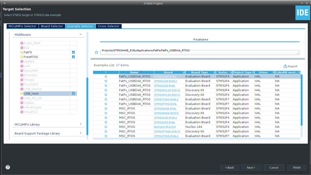

Hello I'm having similar problems, I'm trying to create a new USB Host MSC project (USBdisk), I noticed that the sample library uses version 1 of RTOS.
Here is a website that talks a little more about these differences:
https://arm-software.github.io/CMSIS_5/RTOS2/html/os2MigrationFunctions.html
Hello @Ons KOOLI​ , how are you?
If possible, please update the projects with native examples for STM32CubeIDE and RTOS V2.
It would be very useful if STM updates these examples with STM32CubeIDE and RTOS V2.
It takes time for the new user to find the differences and also prevents new questions about the differences from being created. Thank you.
