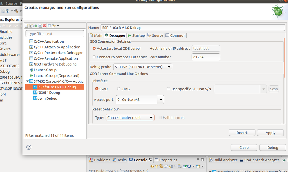

Im not in home, but tomorow will give screenshot. Maybe it will help.
I had the same problem, but different mcu.

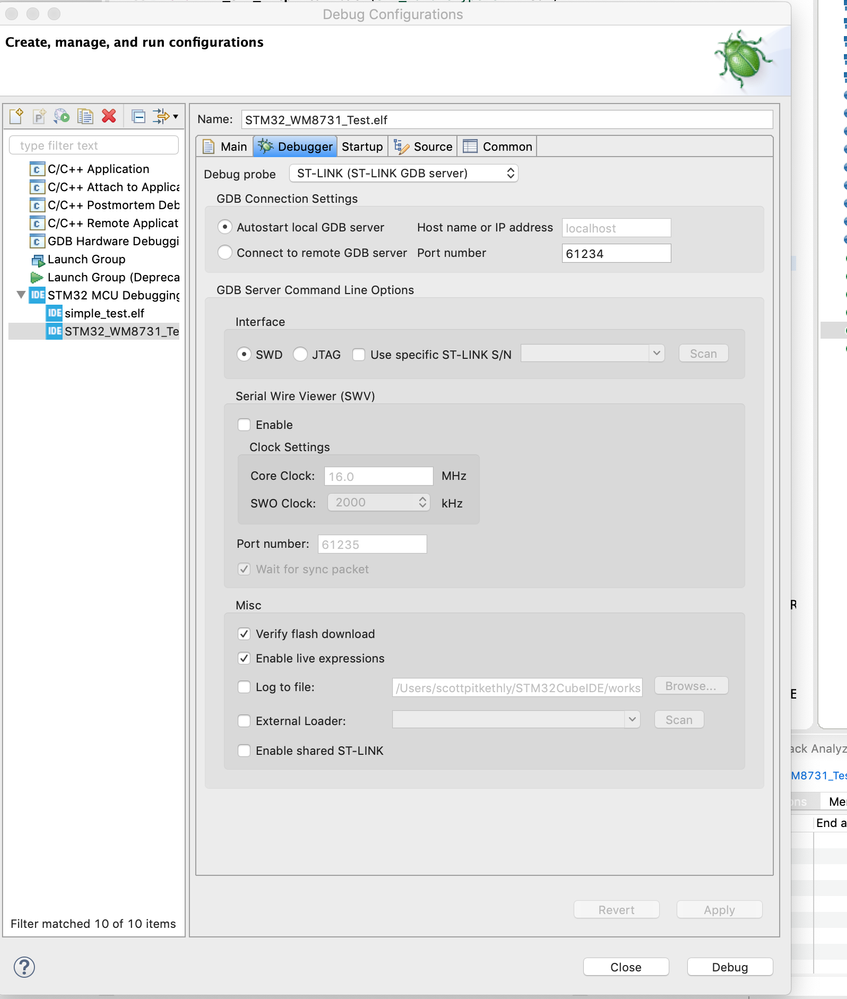

0690X00000BvSU7QAN.pngThanks for doing that! As far as I can tell I have this setup correctly, and it appears to match one of my working projects. The config in the .ioc looks the same as yours, but my 'Create, manage, and run configurations' looks a bit different, screenshot attached

Look in global settings. When you clikc run-debug as-stm32​ ... in run- schould be "configure" or "debug configure".
Cubeide at top of window.​
