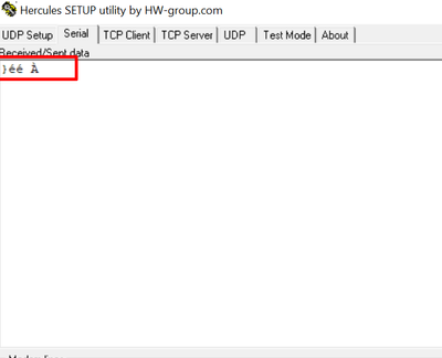

When I run the below code, I get the result on serial console as in below image which is not as expected. Could you please let me know what I am missing here ?

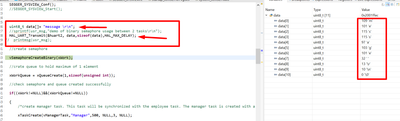

  uint8_t data[]= "message \r\n";
  //sprintf(usr_msg,"demo of binary semaphore usage between 2 tasks\r\n");
  HAL_UART_Transmit(&huart2, data,sizeof(data),HAL_MAX_DELAY);
You have only one uart, but you initialize it twice:
  MX_USART2_UART_Init();
  /* USER CODE BEGIN 2 */
SEGGER_UART_init(250000);
Note that "MX_USART2_UART_Init()" has initialized the uart with baudrate 115200.
Then "SEGGER_UART_init(250000)"  does this again but with baudrate 250000.
Delete the call to SEGGER_UART_init. And try again.

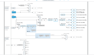

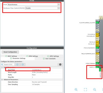

Either you have the settings wrong for baud rate, or wrong HSE_VALUE
For strings use strlen() or sizeof()-1 to not send the NUL over the wire
I am using HSI as shown in below image.
The baudrate should also be OK.
I am using FreeRTOS in my application. May it be causing the issue ?
