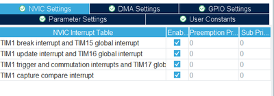

but when i use the interrupt to set the duty cyles always the phase voltages are zero
how to dynamically set the phase voltages in the timer interrupt

1. Use the code insert feature instead of screen dumps.
2. Is your timer callback ever called? Maybe you started the timer without period interrupt enabled. Use the debugger to check it.
3. If it is called, use the debugger to check the values written to CCRx registers.

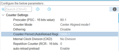

this is my timer config where should i enable period interrupt

‎2024-09-06 5:14 AM
HAL_TIM_PWM_Start does not turn on any interrupts. Use HAL_TIM_PWM_Start_IT instead if you want callbacks to happen.
You can add TIM1->CCR1 to the live expressions to see it.
