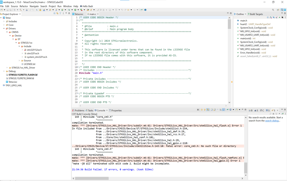

Hi, I'm using STM32CUBEIDE 1.15.0 and I have STM32 nucleo-l152re
I searched Google for the solution but did not find it. The problem is:../Drivers/CMSIS/Device/ST/STM32L1xx/Include/stm32l152xe.h:143:10: fatal error: core_cm3.h: No such file or directory
thank you In advance
    1 reply
    March 20, 2024
    The needed file is here:
    STM32CubeL1/Drivers/CMSIS/Include/core_cm3.h at master · STMicroelectronics/STM32CubeL1 (github.com)
    If CubeMX is not generating it for you, please include the IOC file which produces the issue.
