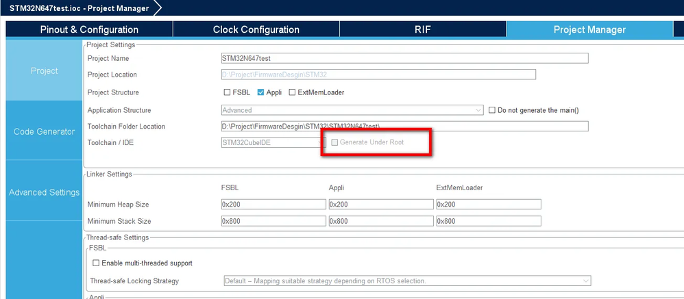

Hi
I created a new project in STM32CubeIDE, but in Project Manager → Project, the “Generate under Root” option is grayed out and cannot be changed. What’s the reason for this?
Mahmoud Ben Romdhane
Hello @Adams ,
When you create or open a project directly in STM32CubeIDE, it automatically manages the code generation paths and structure.
CubeIDE integrates CubeMX internally, so it locks the [Generate Under Root] option to maintain consistent folder management.
You will only see it enabled if you run standalone STM32CubeMX
Thanks.
Mahmoud
