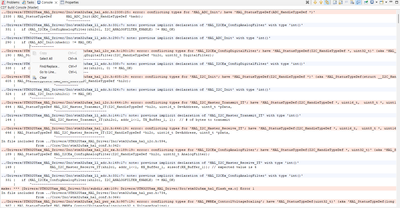

I am currently working on a project using an STM32U5 series microcontroller, and I have encountered a significant build issue with numerous errors related to the HAL driver.
Attached picture is just some of error code. (First and the last page)
It made1675 errors and 381 warnings.
I think my code doesn't have any problem becuase It worked well just few minutes ago.
Thank you.

I don't believe that's the full error list - I'm sure there must have been more errors before the start of that.
The full log would start with something like:
11:25:43 **** Build of configuration Debug for project nucleo-l073 ****
make -j8 all
I'm afraid I can't find the post on where to find the full build log.
I think so too.
because if I re-build the project, the first line of the console change like attatched txt file.
but it still have same amounts of errors (1675 errors and 381 warnings.).
Also, I don't know the other way to capture all of errors.
( I think it's all... I "Select All" and copy paste it )

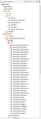

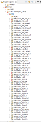

I captured Project Explorer, which shows some error.
I hope it could help to solve the problem..
thanks
How did you create the Project?
If you create it using the CubeMX (or the equivalent within the CubeIDE), that will manage all the required headers for you.
If you created it - or modified it - manually, then you have to do all that yourself.
@eunni wrote:
I don't think it's an iinclude issue, becasue other Slave file (which include same as Master project) work well.
That doesn't follow. The main.h is different for each project - it manages the other required includes.
There is a lot hiding behind that #include "main.h" !
