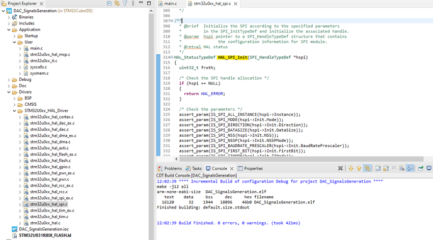

I am putting together a project for the U031 Nucleo board based on the DAC signal generation example project. From the configuration page I have added SPI, as well as TIM2 and the other required drivers (DAC, DMA, EXTI, TIM1). When it generates code, it looks like everything is there in way of configuration but stm32u0xx_hal_spi.c is not included in the drivers to be compiled. When I try to build the project the HAL_SPI_INT function cannot be found. It seems to find all the correct header files and the configuration in stm32u0xx_hal_config.h is correct and SPI is defined but it is not included in the make. It shows all the other required drivers in the driver directory but not spi.  The stm32u0xx_hal_spi.c and stm32u0xx_hal_spi_ex.c files are both in the same project folder with all the other drivers. I have checked the auto generated submake files and spi is not listed.

That is weird because when I add SPI and generate code, I do get the stm32u0xx_hal_spi.c/h files added.
The only issue I saw was the compiler didn't uncomment the code in the stm32u0xx_hal_spi.c, in between the define HAL_SPI_MODULE_ENABLED

Here is a screenshot to show that the SPI driver was added and that HAL_SPI_Init is not commented out after the temporary HAL_SPI_MODULE_ENABLED fix. I can also build with no errors. I've attached the project.
