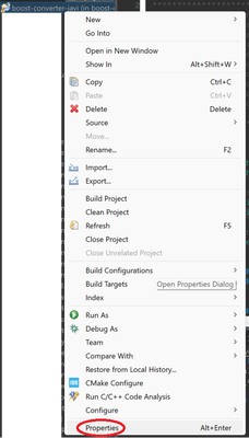

Javier1
Principal
Yup that was fast, i just needed to Right click on my project > properties
and add my folder in includes and source location, it does include subfolders aswell, very convenient
