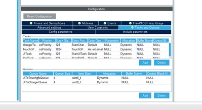

Configuration:

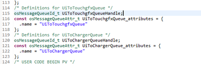

Generated Initialization

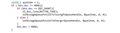

Place item in queue (btn.dec is a uint8_t variable)

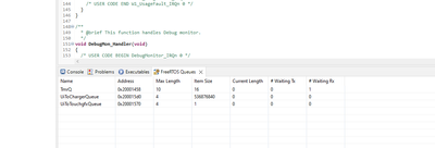

Debug
As you can see the item size is wrong, although the two queues are created equal.
What could cause this?

Ensure that the data you're sending (btn.dec) is indeed a uint8_t. If btn.dec is not a single byte, this could be the source of the problem.
Also, check in the queue creation, that the item size parameter (sizeof(uint8_t)) matches the actual size of the items you will place in the queue.
‎2024-05-08 4:49 AM
Thank you Sarra for your reply. Just to remove any doubts I defined a new uint8_t variable which i am sending to the queue. For me this does not seem to be an issue. Any more ideas?

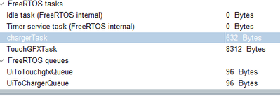

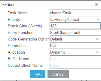

So I was checking the heap size of my FreeRTOS task. There is this "chargerTask". I know that I dynamically allocate about 431 bytes in it. The settings in configuration was as follows:
I can only edit "stack size" on the first image. which is in words. In bytes it is then 512 bytes. According to my understanding it is enough for my dynamic memory, or am i wrong?
Anyway after increasing the stack size to 1024 the problem does not occur anymore.
What would be the correct way of calculating heap/stack size here?

Please check Heap memory management
Typically, you would implement a stack overflow detection mechanism by using the configCHECK_FOR_STACK_OVERFLOW configuration constant in your FreeRTOSConfig.h file, also check Stack usage and Stack Overflow Checking

It seems there were indeed some heap size problem. However a problem with one of the queues still persist. In debug view it shows some randomly high number as an item size. Both queues are created by configuration tool. Any idea what could cause this?
in main.c:
