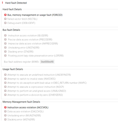

I'm trying to debug the stm using stm32CubeIDE, I'm having a Hard Fault at the HAL_Init().

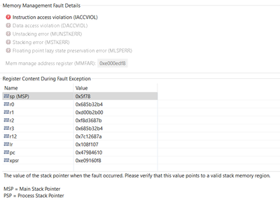

Well, the SP and PC values are BOTH not valid (well, SP maybe if RAM is mapped to address 0, I don't recall if that can happen on the L4xx).

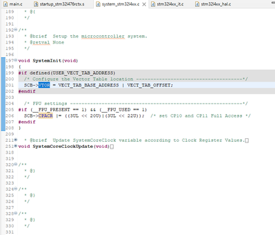

You have the source code.  Use the debugger, step through the HAL_Init() and see where/why it fails.  Make sure the VTOR register is pointing to the actual vector table (look in system_stm32l4xx.c).

The code isn't stucking at the HAL_Init() anymore. I did the debug with breakpoint, the code fails at the SystemClock_Config() and it's pointing to the void HardFault_Handler(void) and stucking in the while(1).
However, the error in the fault analkyser is the same (MPS, SP values). Noting that I don't have error in the clock configuration.
For the VTOR register, it's set in the void SystemInit(void).

Did you single-step through the SystemInit() code to verify that the VTOR gets set?  Because it looks like your editor is showing you that the VTOR code is DISABLED (i.e. USER_VECT_TAB_ADDRESS is not defined).  Notice how the VTOR code is grayed out, while the FPU code below is not.
[EDIT] The fact that the fault handler is triggered from a different place may just be a timing issue before the first interrupt happens.
