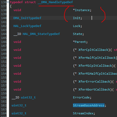

I want to access the NDTR value, and I'm porting the user codes from ARM KEIL to STM32CubeIDE.
When I used ARM KEIL, I was able to access the NDTR value, but now I'm using STM32CubeIDE and I cannot access it.
currently, I don't know where the issue is in the user code, and I assume to issue with Instance declaration, but I declared Instances such as huart1 and hdma_usart1_rx.
Any help is greatly appreciated!
Friendly regards, Tau

+) The issue has been solved, and I modified type of instance, member of __DMA_HandleTypeDef from void to DMA_Stream_TypeDef.
After checking files with DMA, there are no problems.
Isn't it a problem related declarations of UART_HandleTypeDef and DMA_HandleTypeDef, by any chance?

#2 stm32h7xx_hal_dma.h file

Is WON_UART.h one of your files?
Check also stm32h7xx_hal_conf.h for DMA structures being pulled into the build.
