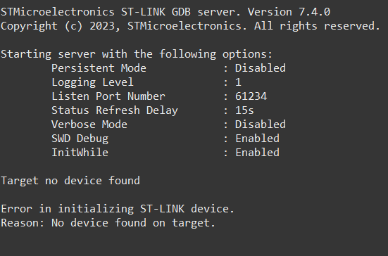

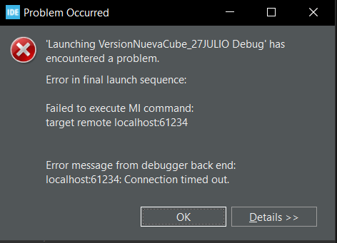

I was just uploading the code without having any issue and after the new update of Cube IDE it just does not recognise the ST-LINK of the Discovery board (STM32F469). I attach the images. I tried to reset the board but can do it via ST-LINK Utility.
Does anyone know how to solve this :((??????

ST-Link Utility has been deprecated for many years. Possibly new firmware versions (which STM32CubeIDE forces on you) causes it to fail.
Does it work with STM32CubeProgrammer?
No, it doesn't say that. It says that it cannot connect to the target MCU device. And the ST-LINK Utility even shows a proper recommendation of what must be tried.

Enekkk
It does not work with the CubeIDE, does not let me to upload the code
