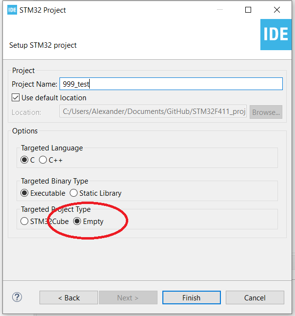

Having generated a blank STM32F303 project in STM32CubeIDE, my main file has the following code
#if !defined(__SOFT_FP__) && defined(__ARM_FP)
  #warning "FPU is not initialized, but the project is compiling for an FPU. Please initialize the FPU before use."
#endif
My compiler flags are among others -mfpu=fpv4-sp-d16 -mfloat-abi=hard
I get the following warning as a compilation output:
../Src/main.c:10:4: warning: #warning "FPU is not initialized, but the project is compiling for an FPU. Please initialize the FPU before use." [-Wcpp]

Those are gcc built-in defines which depend on the machine/arch/... options you are using. You can show them by preprocessing an empty file and dumping the output to stdout like:
arm-none-eabi-gcc.exe -mcpu=cortex-m4 -dM -E - < /dev/null
Replace /dev/null by NUL for Windows.

Hmm. Just generated STM32CubeMX code for STM32F302RB Nucleo board (the closest match I own). There is not such #if ... block generated in my main.c or anywhere else in the project.
The rationale is, that the FPU needs initialization before the first FPU instruction is executed. This is handled in SystemInit(); in system_stm32f3xx.c:

I generated a blank STM32CubeIDE project, see attached figure. When using the pin configuration tool and generating a HAL based project, the #if ... block is not generated, either.

> did you end up with HAL/LL and a setup of your MCU?
Yes, you're right. I'm using "Empty" rarely, but tried it now and got the same code sequences as you did. Note that __SOFTFP__ will be defined when you invoke gcc with  -mfloat-abi=soft and __ARM_FP is defined when specifying -mfloat-abi=hard. So, the generated #if block shall remind you to add a line for FPU initialization because no SystemInit() code is generated in "Empty" projects.
Did you try FPU instructions? When the FPU was not initializied, you will get a fault at runtime (no coprocessor).
