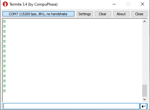

PMeno.1
PMeno.1Author

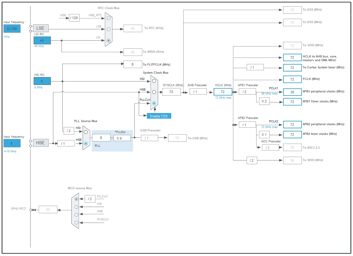

November 9, 2021
I get it to work, both led blink and HAL_UART_Transmit(...).
First of all i used the same offset(for the bootloader) as marlin 3d printer firmware for the creality board(in my code instead of ROM it is FLASH): https://github.com/MarlinFirmware/Marlin/blob/2.0.x/buildroot/share/PlatformIO/ldscripts/creality.ld
At the beggining i was't even able to tongle the pin, finaly i had to make some changes to clock configuration and everything worked:
One more issue i am facing is that the HAL_Delay() is blocking that is why i could not send in the while loop. Still not able to solve this but i used another way. Below you can find the source:

   HAL_UART_Transmit(&huart1, (uint8_t*)"H\n", 2, 100);

void SystemClock_Config(void)
 RCC_OscInitStruct.OscillatorType = RCC_OSCILLATORTYPE_HSE;
 RCC_OscInitStruct.HSEState = RCC_HSE_ON;
 RCC_OscInitStruct.HSEPredivValue = RCC_HSE_PREDIV_DIV1;
 RCC_OscInitStruct.PLL.PLLSource = RCC_PLLSOURCE_HSE;
 RCC_OscInitStruct.PLL.PLLMUL = RCC_PLL_MUL9;
  Error_Handler();
 RCC_ClkInitStruct.APB1CLKDivider = RCC_HCLK_DIV2;
 RCC_ClkInitStruct.APB2CLKDivider = RCC_HCLK_DIV1;
 if (HAL_RCC_ClockConfig(&RCC_ClkInitStruct, FLASH_LATENCY_2) != HAL_OK)
  Error_Handler();

And here is a screenshot from termite:
