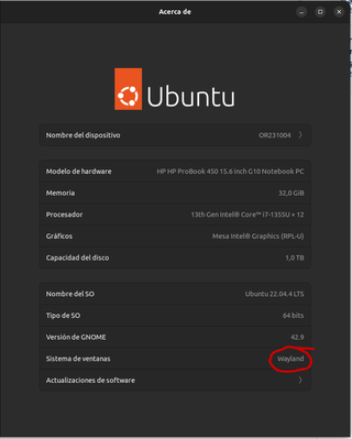

    It is not that the IDE crashes, but it stops updating the window, so it freezes and it is impossible to work with it.
    The configuration in which this happens is:
    It works fine in X11

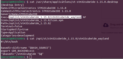

    The STM32CubeIDE uses this shortcut:
    user7
    April 2, 2024
    take a look at the contents of the file that you have marked in the screenshot. It has the same name than the file I mentioned. You can open it in your preferred text editor (e.g. kate). Does it have the export GDK_BACKEND=x11 entry? If not, add it.

    I tried your solution (adding Adwaita theme) but it doesn't work.
    The file already contained GDK_BACKEND=x11 theme entry.

    I've just encountered this problem, today. The answer, for me, was to remove GDK_BACKEND=x11 from /opt/st/stm32cubeide_1.17.0/stm32cubeide_wayland
