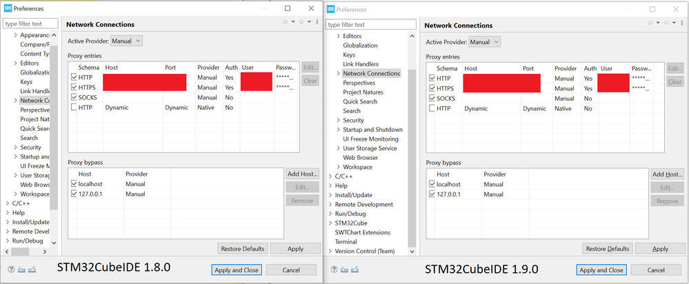

Markus, looking under Window>Preferences>General>Network Connections and there is a difference in the entries between v1.8.0 and v1.9.0.(See Pic.) First would this difference cause v1.9.0 to not be able to connect to software update sites? If so, is there a way to add an entry to the Proxy Entries window to duplicate what is in v1.8.0? I tried to export the preferences from v1.8.0 and import them into v1.9.0 but that did not seem to work. (on restart the entry was not saved.) Any info would be appreciated.
Hmm, I tried to do the same thing from my end but I don't get the same result. I'm not sure if anything was changed due to me previously having set-up my corporate login but this is how it looks for me in both versions:
BMohl.1
Markus, I am assuming in the pic you sent me Host/Port/password
are my Corporate login details?
Yes, that's correct.
