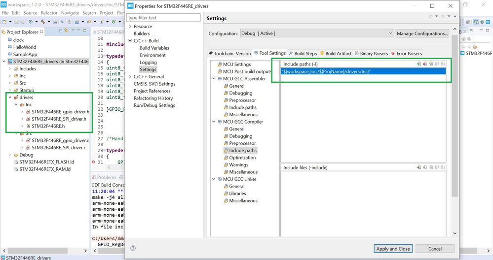

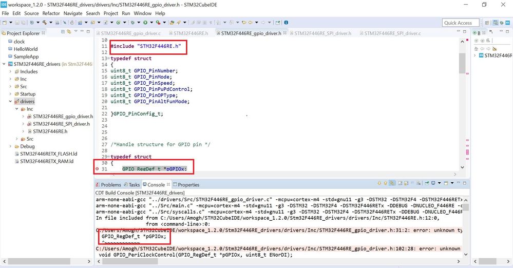

I am facing similar kind of situation. When the header file is included in the code it is not showing any errors but when built it does not recognize the hearder file included by giving errors for all the elements of the included heder file saying unknow type names. Any help would be appreciated.
I have even added the requred paths.
Please check the below screenshots of the error and added paths.
Thank you,

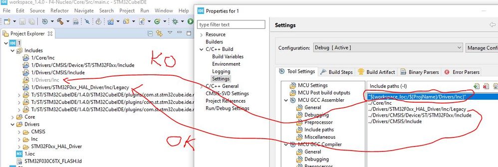

‎2020-07-28 11:33 PM
"But if I create project new STM32 project (not from .ioc file) " are you working with STM32CubeMX or STM32CubeIDE here ?
"all work true" means you have used File > New STM32 Project but which options then ? (Empty or STM32Cube project types ?)
Where is your project.h located on file system ? Possibly share a screen snaphot of your project showing includes setups and file structure ...
In meantime takes care could be same as : https://community.st.com/s/question/0D53W00000DJpGPSA1/file-added-and-path-added-but-still-get-no-such-file
Takes care about your include coloring ... Is such include setupeffective from Eclipse point of view already ? Please could you check if such line is leading to plain or grayed include like following snapshot ... if grayed means Eclipse not able to reach
