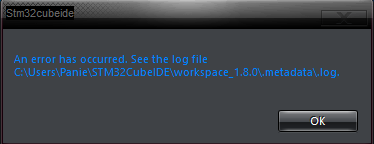

yesterday installed new ide 13.1 , because H563-nucleo board not working with "old" v10.
after some trouble with new "forced login feature" i could make new project from H563 examples.
then i could compile and flash / debug. seem ok so far, then close and shutdown.
then today, start IDE ( on this new workspace) and it cannot start - just "an error has occurred. see log file...metadata.log" .
come on, what now?
i seen a comment, if problem with new v13 , just delete metadata (ok, i moved to other directoty, to be able to use it again.)
then ide starting up, bt no projects found. ok, i "open new..from filesystem" and it is here again.
but now...cannot compile ! -> error " warning: no encoding set .." .  hmmm...
close ide.
open again...and voila : "an error has occurred. see log file...metadata.log" .
perfect.
what can i do now ???

To help to dig into your symptoms analysis, is that possible that you share the content of the log files.
In your workspaces directories, there is a directory name .metadata.
Could you please make a zip of all files that are located in this .metadata folder (do not include the subdirectories).

btw i tried re-install, make new project - works. next start same : error, see log. no chance to work with STM32IDE.

now the TEST : close and open ide then... dazong.  no more ide , error -> see log file.
i think, i give up on this....
