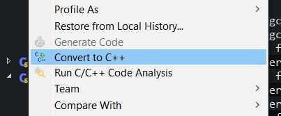

Usint STM32Cube IDE 1.0.2 with STM32F0, we need to set the project setting to C++ every time we regenerate the core code.
It is a bit annoying.

This is fixed in our internal builds and will be released soon.

Definitively a bug.
Sounds some improvements have been done Thanks STM32CubeIDE V1.1.0 just released on st.com
